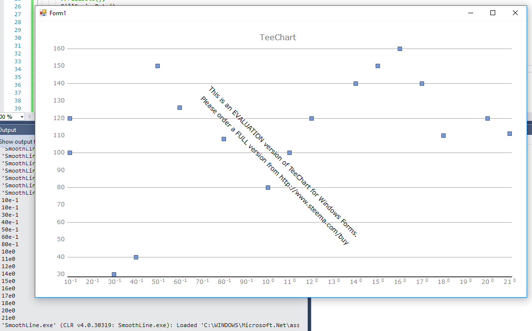

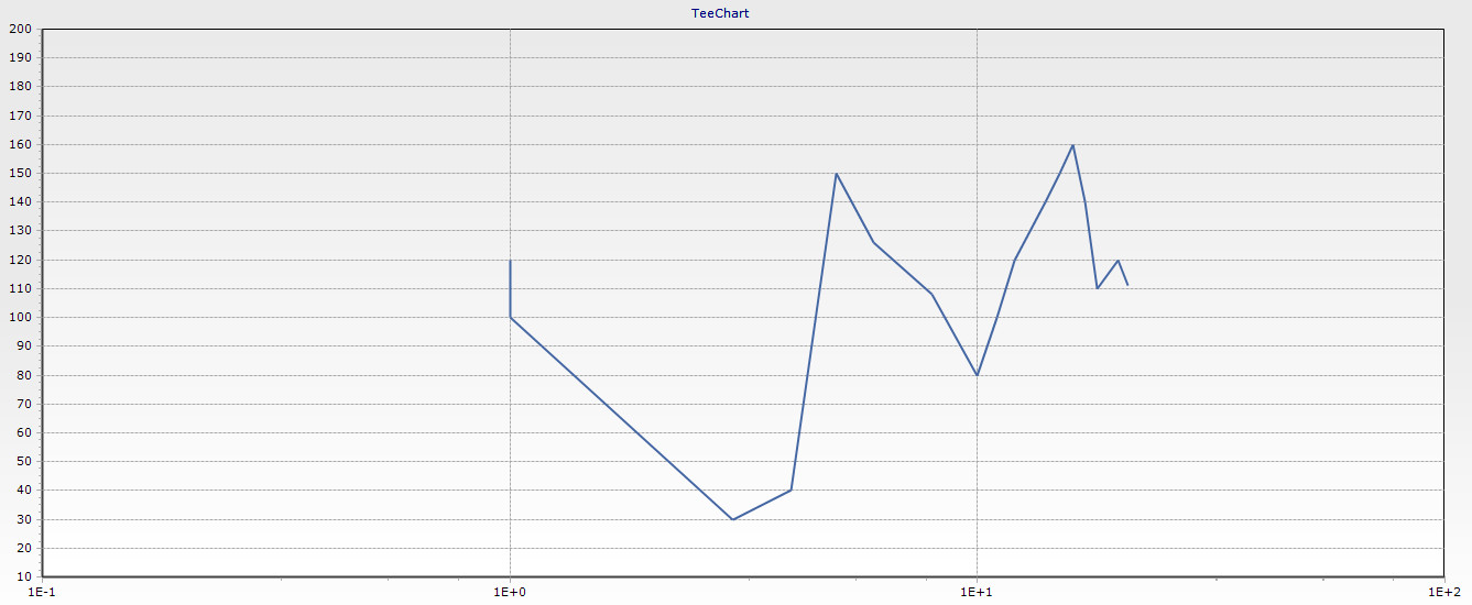

Case1
When we set label format in exponential then labels of bottom axis shown in below figure:
tChart1.Axes.Bottom.Labels.ValueFormat = " 0.####E+0";
Case2
When we want to show the bottom axis labels in 10th power.
for this we have set following properties
tChart1.Axes.Bottom.Labels.Exponent = true;
tChart1.Axes.Bottom.Labels.ValueFormat = "00e0";
But here in above figure, the labels of bottom axis are not showing correct values label.
Currently it is showing following labels: 10¯², 10¯¹, 10⁰, 10¹.
But the correct labels value should be: 10¯¹, 10⁰, 10¹, 10².

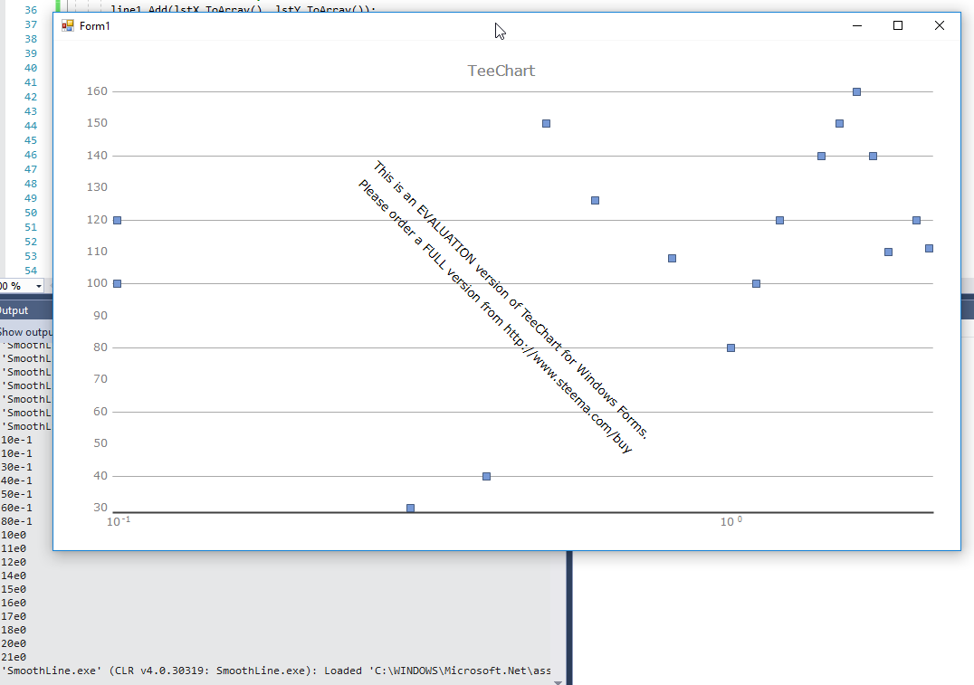

Re: Set axis labels in 10th power.
Post by Christopher » Wed Oct 17, 2018 7:52 am
Hello Amol,

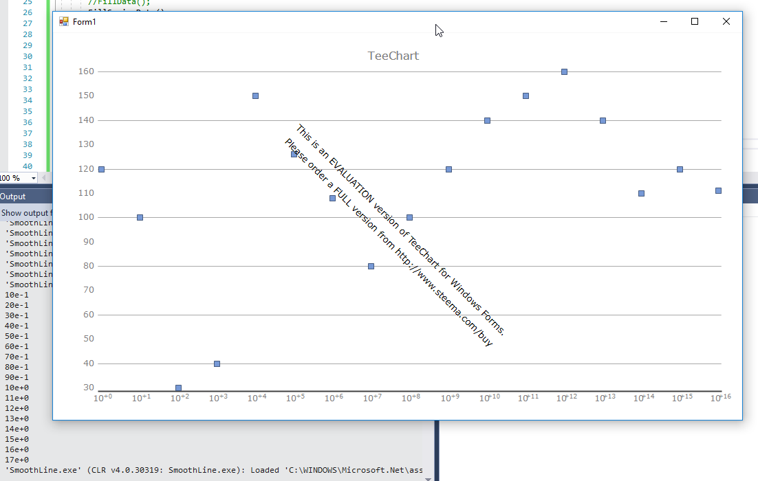

When I run this code using the latest public version of TeeChart.dll (available here):
			//FillData();
			FillSeriesData();
			this.Controls.Add(tChart1);
			tChart1.Aspect.SmoothingMode = System.Drawing.Drawing2D.SmoothingMode.HighQuality;
			Steema.TeeChart.Styles.Points line1 = new Points();
			line1.ShowInLegend = false;
			line1.VertAxis = VerticalAxis.Left;
			line1.LinePen.Width = 2;
			//line1.Smoothed = true;
			line1.Add(lstX.ToArray(), lstY.ToArray());
			string format = "00e0";
			List<string> strings = lstX.Select(x => x.ToString(format)).ToList();
			strings.ForEach(x => Console.WriteLine(x));
			tChart1.Series.Add(line1);
			//tChart1.Axes.Bottom.Logarithmic = true;
			tChart1.Axes.Bottom.Labels.ValueFormat = format;
			tChart1.MouseDoubleClick += TChart1_MouseDoubleClick;
I obtain the following:
This chart is correct, as you can see - the strings we write out in Console.WriteLine using code which is independent of TeeChart match exactly the strings TeeChart writes out in the bottom axis.

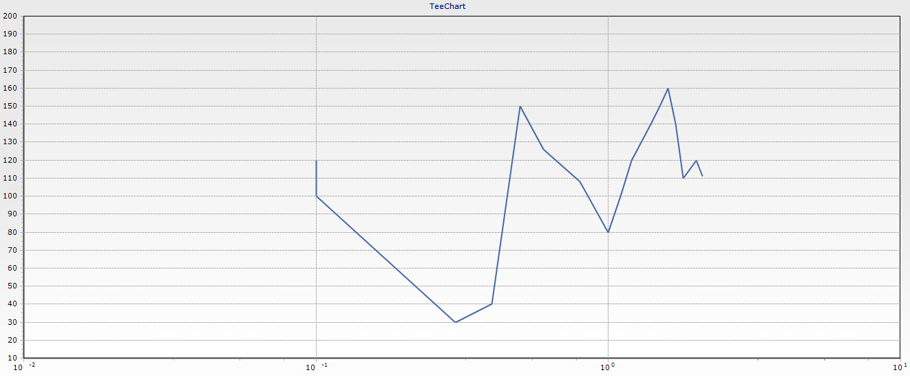

Now when we use this code:
			//FillData();
			FillSeriesData();
This chart is also correct - it has to be correct, because the previous chart was correct, which is to say that the label '10⁰' is correctly positioned.

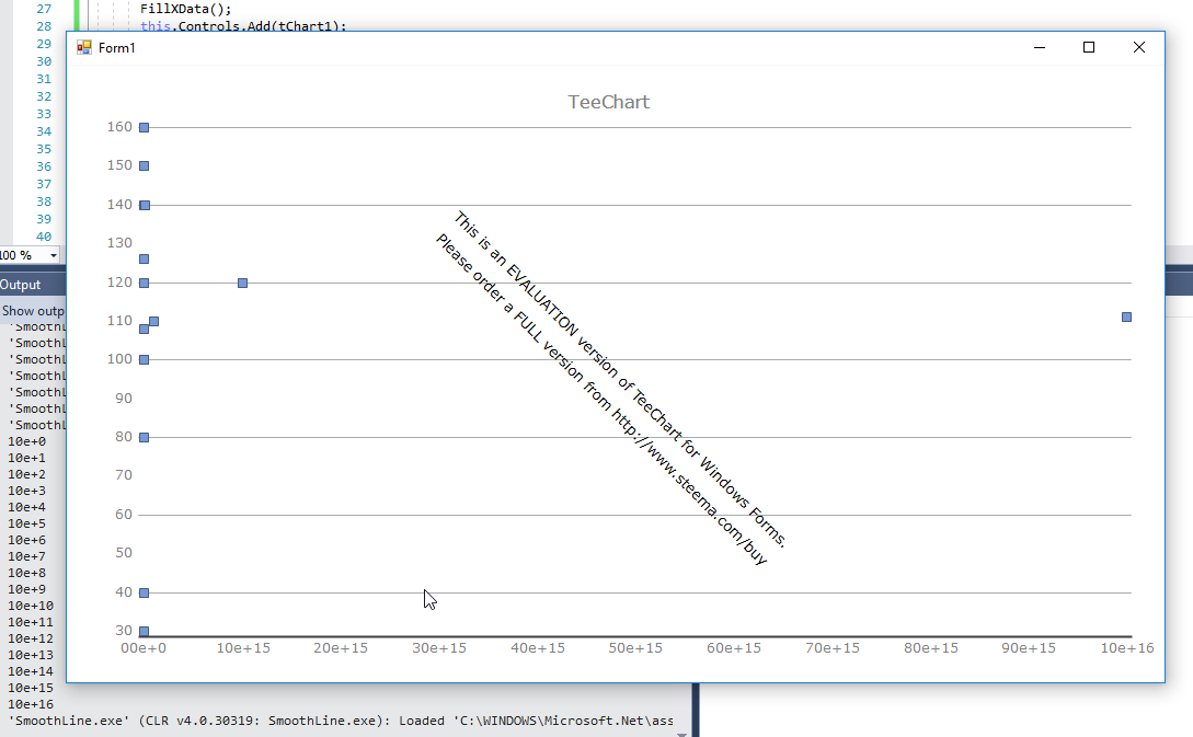

I think confusion is occuring because TChart does not display the logarithmic value of the points on the labels - it displays their actual values but plots the values as logarithmic. Here's some code that explains what I mean:
			//FillData();
			FillSeriesData();
			FillXData();
			string format = "00e+0";
			//tChart1.Axes.Bottom.LogarithmicBase = 10;
			//tChart1.Axes.Bottom.Labels.Exponent = true;
		private void FillXData()
			lstX.Clear();
			double ten = 1;
			for (int i = 0; i < 17; i++)
				ten *= 10;
				lstX.Add(ten);
and the result:

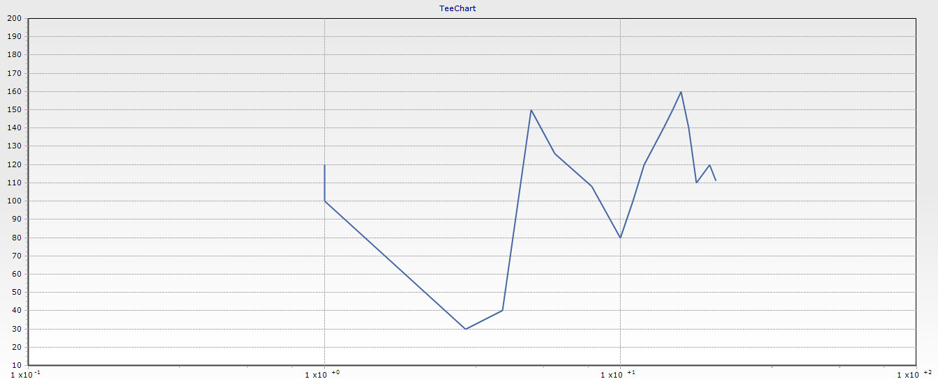

I think we can agree this is correct. Now if we use logarithmic both on the xvalue strings and on the bottom axis:
			//FillData();
			FillSeriesData();
			FillXData();
			List<string> strings = lstX.Select(x => Math.Log10(x).ToString(format)).ToList();
			lstX.Clear();
			double ten = 1;
				ten *= 10;
				lstX.Add(ten);
we obtain:
Here we can see that the chart plots the xvalues as logarithmic values, the values you can see in Console.WriteLine, but the labels are still the actual (non-logarithmic) value of each point.
