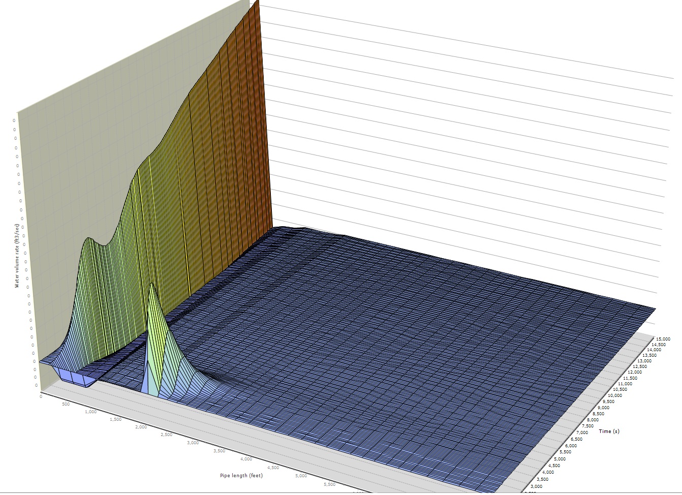

There are issues with Zoom/Rotate interactions with 3D Surface plots. Essentially the mesh distorts or breaks apart and eventually asserts .
The code we are using worked fine with the 2011 DotNet version ( and we have tested on more than one machine with different graphics cards)
Version tested: TeeChartNET2018_4.1.2018.05040
I have created a simple bi-variate normal distribution curve to demonstrate the problem (our actual data/code is obviously more complex).
A screenshot is included to demonstrate the actual data.

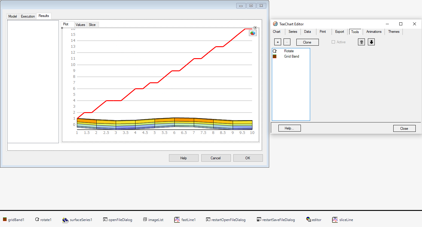

I have also tested our actual application with real data (see the screenshot in last post) and both the Mesh tearing and overflow error still exist ( to a lesser extent).
I am using a gridband, slice line, fast line and rotate tools ( something is still asking for version 4.1.2018.5046) when I display my plot ( I can find no trace of a version reference in my project, license etc)

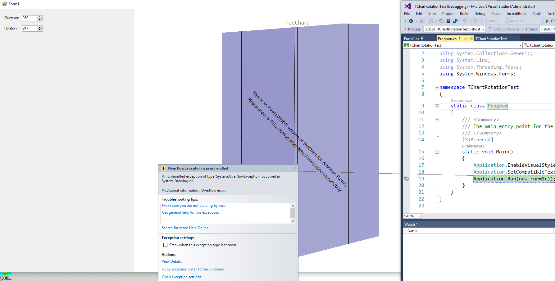

Joined: Thu Jul 05, 2018 12:00 am
Re: 3D Surface plot Zoom/Rotate issues
Post by PetexUser » Fri Sep 28, 2018 12:36 pm
Yes I have tried deleting the license file contents and additional version information entries in my VS project files.
I run my application I see the evaluation banner on the 2D plot which leads me to conclude I have built with the evaluation version.
I display the 3D surface plot and a failed to read the assembly 4.1.2018.5046 but I can continue and the 3D plot is displayed
I perform a series of zoom/rotate actions as before ( there is tear up and the asset appears)
************** Exception Text **************
System.OverflowException: Overflow error.
at System.Drawing.Graphics.CheckErrorStatus(Int32 status)
at System.Drawing.Graphics.FillPolygon(Brush brush, Point[] points, FillMode fillMode)
at Steema.TeeChart.Drawing.Graphics3DGdiPlus.Polygon(Point[] p)
at Steema.TeeChart.Drawing.Graphics3D.PolygonFour()
at Steema.TeeChart.Drawing.Graphics3D.PlaneFour3D(Int32 z0, Int32 z1, Point[] p)
at Steema.TeeChart.Styles.Surface.(Int32 )
at Steema.TeeChart.Styles.Surface.DrawCell(Int32 x, Int32 z)
at Steema.TeeChart.Styles.Surface.()
at Steema.TeeChart.Styles.Surface.Draw()
at Steema.TeeChart.Styles.Series.DrawSeries()
at Steema.TeeChart.Chart.(Graphics3D , Int32 , Int32 , Int32 )
at Steema.TeeChart.Chart.(Graphics3D )
at Steema.TeeChart.Chart.(Graphics , Boolean )
at Steema.TeeChart.TChart.Draw(Graphics g)
at Steema.TeeChart.TChart.OnPaint(PaintEventArgs pe)
at System.Windows.Forms.Control.PaintWithErrorHandling(PaintEventArgs e, Int16 layer)
at System.Windows.Forms.Control.WmPaint(Message& m)
at System.Windows.Forms.Control.WndProc(Message& m)
at System.Windows.Forms.NativeWindow.Callback(IntPtr hWnd, Int32 msg, IntPtr wparam, IntPtr lparam)
************** Loaded Assemblies **************
mscorlib
Assembly Version: 4.0.0.0
Win32 Version: 4.7.3110.0 built by: NET472REL1LAST_C
CodeBase: file:///C:/Windows/Microsoft.NET/Framework64/v4.0.30319/mscorlib.dll

Here are the results using the BeforeDraw event up to the Zoom/Rotate overflow.
Hope this helps.
kindest regards
Test data
windows\dwm\dwmapi\attribute.cpp(92)\dwmapi.dll!71833CF4: (caller: 718890ED) ReturnHr(52) tid(1234) 80070006 The handle is invalid.
Rotation 16 Elevation 276 Zoom 100
Rotation 345 Elevation 280 Zoom 100
The thread 0x4108 has exited with code 0 (0x0).
Rotation 316 Elevation 297 Zoom 100
Rotation 316 Elevation 298 Zoom 100
Rotation 300 Elevation 324 Zoom 100
Rotation 299 Elevation 327 Zoom 100
Rotation 297 Elevation 331 Zoom 100
Rotation 294 Elevation 350 Zoom 100
Rotation 266 Elevation 360 Zoom 100
Rotation 250 Elevation 360 Zoom 100
Rotation 274 Elevation 357 Zoom 100
Rotation 279 Elevation 360 Zoom 100
Rotation 252 Elevation 360 Zoom 100
Rotation 251 Elevation 360 Zoom 100
An unhandled exception of type 'System.OverflowException' occurred in System.Drawing.dll
Additional information: Overflow error.
c.f. with Actual data
windows\dwm\dwmapi\attribute.cpp(92)\dwmapi.dll!71833CF4: (caller: 718890ED) ReturnHr(115) tid(e2c) 80070006 The handle is invalid.
Rotation 255 Elevation 360 Zoom 66
