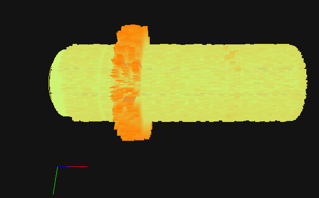

Hello, we use Teechart WPF
is it possible to display a 3D pipe?
Currently we use a dll for windows forms to display a 3d pipe and would like to switch to a Teechart wpf.

TeeChartFor.Net offers you use Volume Pie to draw a Pipe 3D. The same series works in wpf without problems.
The code below shows you how can use that:
 private void InitializeChart(){
   	tChart1.Aspect.View3D = true;
	Steema.TeeChart.WPF.Styles.VolumePipe pipe1= new Steema.TeeChart.WPF.Styles.VolumePipe(tChart1.Chart);
	pipe1.FillSampleValues(100);
	tChart1.Legend.Visible = false;}

The data in the image example is 2 Dimensional, I need a data representation on the circumference of the cylinder with many slices. In the example image are 400 slices with 360 data points each around the circumference. Is there a Teechart Type that can do that?
I don't think there is, no, but that doesn't stop you from making one. We can help you to do so. Do you have a set of example data along with the mathematical operations you wish to perform on it to enable this representation?
