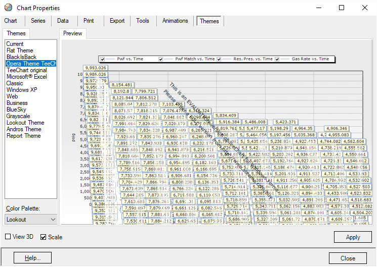

We are in the process of evaluating an upgrade of the TeeChart .Net 2011 version to TeeChart .Net 2018 Version=4.1.2018.5046.
On applying the update we are seeing some new issues (with code that worked previously with the 2011 version).
The main issue concerns Themes. We are seeing the appearance of all MarkTips (turned on) for all data points in all 2D series line plots both in the Theme preview(editor) and on applying the theme to the underlying plot.
• Choose any theme and the preview pane shows floating tooltips for all points and all series (see attachment).
• On applying a theme the chart matches the preview (i.e. with all tool tips visible for all points).
• It does not matter which Theme you choose.
• If we clear the series data and re-add all series data after applying a theme then everything is ok.
Any advice would be appreciated.

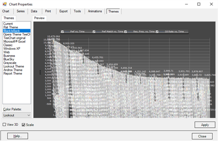

Thank you for the information.
I have tried the evaluation version as you suggested.
Good news some of our issues are now resolved.
However the main issue with Themes (and MarkTips) remains.
Is there anything further we can try ?

Sorry for the confusion this problem does not involve Tee files import (That was my original question).
The issue here is that Theme selection through the Tee Editor sets All marker tips to be displayed.
I cannot reproduce this with a single series but the (2 series) code snippet below reproduces the issue for me.
Steps to reproduce:
1. Setup a plot with 2 series as below.
2. At runtime bring up the TeeEditor
3. Navigate to the Theme Tab and select any theme
4. The preview will show all MarkTips are on
5. Apply the theme (all mark tips are turned on i.e. on the actual plot as per previous screenshots)
6. Navigate to Series-Mark Tab
Series-Marks-All Series Visible is checked for each series
- Deselect the All Series option
- Reselect the Visible option
7. Close the Tee Editor
Result all Mark tips are visible for all points
Note
- When I change the Theme type (at step 3) both options are on by default.
If the plot has a large number of points I would argue that All series Visible default should be off (unchecked).
- If I switch the series back and forth (at step 6) with the drop down list the (All series and Visible) settings
are not remembered i.e. both options are turned(back) on(checked) when I select a different series.

The good news is that the fix does work as expected when I change the Theme type in the Tee Editor, thank you for this.
There are still issues if you navigate to Series ... Marks Tab (in the TeeEditor) but I can I can see that may be the desired behaviour so this is OK.
In my two series example:The Visible and All Series Visible options are both checked if you navigate to Series ... Marks Tab and (the check boxes) do not remember state if you turn All Series Visible off and change the series (drop down).
Thank you gain for your support
I am sorry looks like my earlier reply did not post.

Hello!
Uncommenting this out enables the Chart Editor to be opened correctly on the Series Marks (I have already corrected this issue here). Once this is done I then run the following code:
and when I run this code and open the Chart Editor using:
I obtain the following:
As you can see, this is different to what you describe.
I'm not sure I can reproduce this with the TeeChart.dll I sent you in my last message. First off, the Chart Editor does not open on the Series Marks because of the following line:
