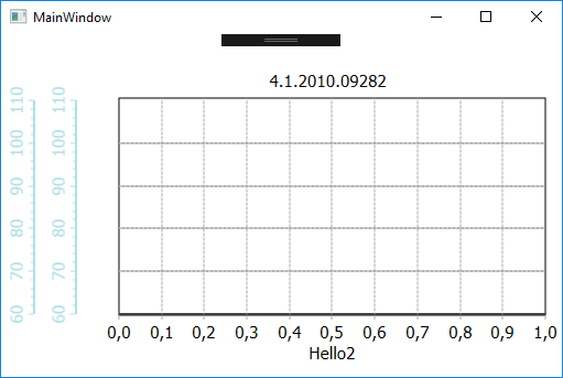

Please see the attachments where 1.jpg is the appearance with Older version and 2.jpg is the appearance with the latest version.
Ex: You can notice that the top and right borders are missing with latest versions of the Teechart assembly.
Please assist us in this regard that why did the appearance got changed after upgrading the latest assembly and how to overcome it.
It is critical for our clients to retain the same look and feel without any degrade in the functionality.

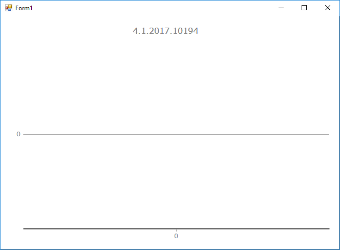

When I run the following code using the TeeChart version you are using:
			TChart chart = new TChart();
			chart.Dock = DockStyle.Fill;
			chart.Header.Text = Utils.Version;
			Line series = new Line(chart.Chart);
			this.Controls.Add(chart);
I obtain the following:
This is what the default chart looks like with a series with no values in it. This default chart is different to the default chart you show me in your images, and it is different because you are coding the chart to make it look different. Could you please give me the code you are using to make your chart look the way it does? Without being able to reproduce your default chart here I'm afraid we won't be able to help you.

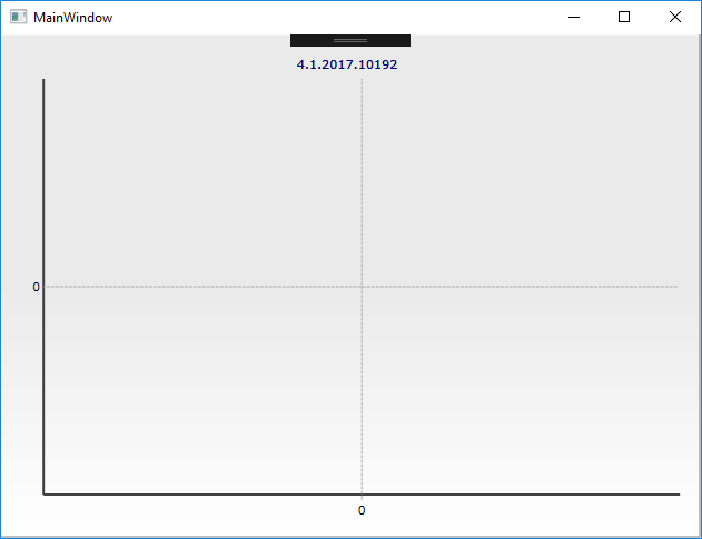

Christopher wrote:Could you please give me the code you are using to make your chart look the way it does? Without being able to reproduce your default chart here I'm afraid we won't be able to help you.
Further to this - to bring this default look to previous versions of several years ago, you can use a single line:
			chart.CurrentTheme = ThemeType.Opera;
which gives us this:
this could be the answer you are looking for.

The code I posted is for TeeChart.dll, the Windows Forms version of TeeChart. Using the TeeChart.WPF.dll, the WPF version of TeeChart, the following code is required:
		public MainWindow()
			chart.Margin = new Thickness(0);
			Steema.TeeChart.WPF.Styles.Line series = new Steema.TeeChart.WPF.Styles.Line(chart.Chart);
			this.grid1.Children.Add(chart);
which gives:

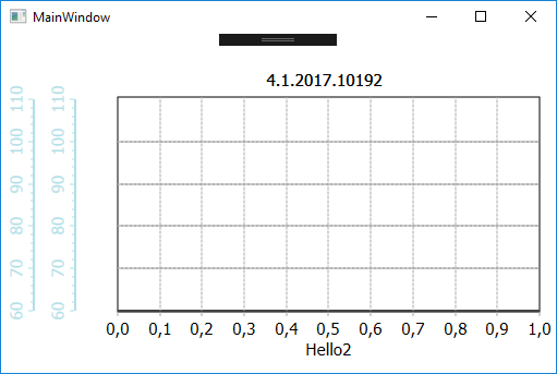

Yes, there are two lines you can add to obtain this border, i.e.
		public MainWindow()
			chart.Walls.Back.Visible = true;
			chart.Walls.Back.Pen.Visible = true;

Okay, I think we have a solution. Using the following code in the two versions I obtain:
		TChart tChart1 = new TChart(false); //<- set false in the constructor for latest version
		public MainWindow()
			string Version()
				string version = typeof(Chart).Assembly.GetName().Version.ToString();
				if (version.Length == 13)
					version = version.Insert(9, "0");
				return version;
			tChart1.Panel.MarginLeft = 1;
			tChart1.Panel.MarginRight = 1;
			tChart1.Panel.MarginTop = 10;
			tChart1.ClipToBounds = true;
			tChart1.Aspect.ClipPoints = true;
			UpdateTeechartBasicSettings();
			UpdateTeeChartDisplaySetting();
			FillTeeChartSeriesDataDesignTime();
			tChart1.Header.Text = Version();
			this.grid1.Children.Add(tChart1);
