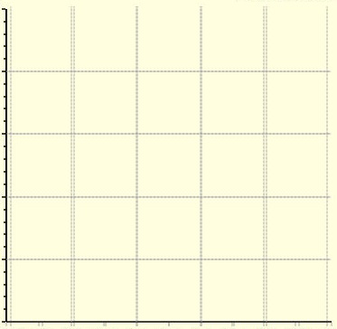

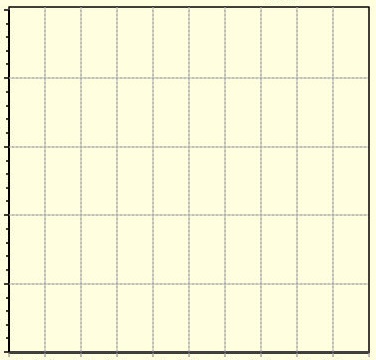

After using the recent updated Teechart assembly, one of our client is complaining that the default look of the component has been changed.
Please see the attachments where 1.jpg is the appearance with Older version and 2.jpg is the appearance with the latest version.
Ex: You can notice that the top and right borders are missing with latest versions of the Teechart assembly.
Please assist us in this regard that why did the appearance got changed after upgrading the latest assembly and how to overcome it.

- New Version
- 2.jpg (21.7 KiB) Viewed 29018 times
- Old Version
- 1.jpg (27.47 KiB) Viewed 29019 times

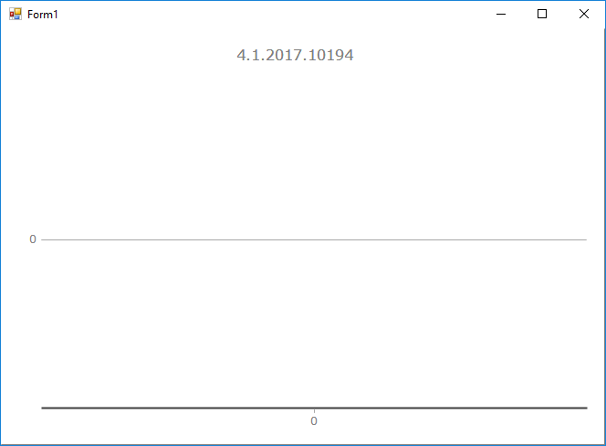

When I run the following code using the TeeChart version you are using:YTI wrote: Creating a sample app to demonstrate the issue isn't feasible.
Can you suggest me the relevant property to bring back the original look?
TChart chart = new TChart();
chart.Dock = DockStyle.Fill;
chart.Header.Text = Utils.Version;
Line series = new Line(chart.Chart);
this.Controls.Add(chart);

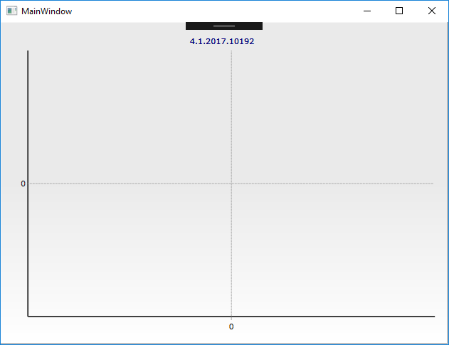

This is what the default chart looks like with a series with no values in it. This default chart is different to the default chart you show me in your images, and it is different because you are coding the chart to make it look different. Could you please give me the code you are using to make your chart look the way it does? Without being able to reproduce your default chart here I'm afraid we won't be able to help you.

Further to this - to bring this default look to previous versions of several years ago, you can use a single line:Christopher wrote:Could you please give me the code you are using to make your chart look the way it does? Without being able to reproduce your default chart here I'm afraid we won't be able to help you.
chart.CurrentTheme = ThemeType.Opera;

The code I posted is for TeeChart.dll, the Windows Forms version of TeeChart. Using the TeeChart.WPF.dll, the WPF version of TeeChart, the following code is required:
which gives:
public MainWindow()
chart.Margin = new Thickness(0);
Steema.TeeChart.WPF.Styles.Line series = new Steema.TeeChart.WPF.Styles.Line(chart.Chart);
this.grid1.Children.Add(chart);

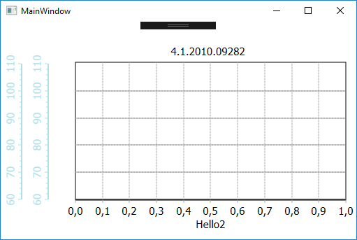

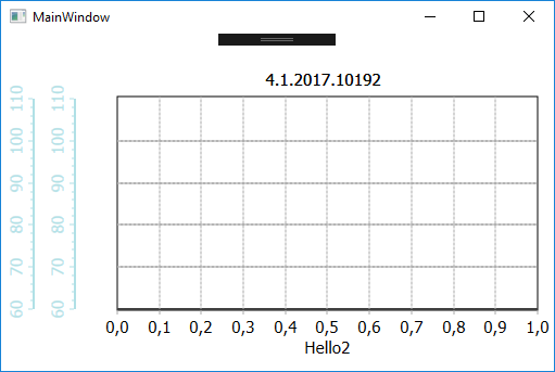

Hi Christopher,
Thanks for sharing two new properties related to Border.
Were these properties enabled by default previously and turned off in later versions?
Please find a sample project to note the difference between the old and new assembly of TeeChart.WPF.dll.
Kindly add the reference of the versions as I mentioned earlier and see the notable differences.

Okay, I think we have a solution. Using the following code in the two versions I obtain:
TChart tChart1 = new TChart(false); //<- set false in the constructor for latest version
public MainWindow()
string Version()
string version = typeof(Chart).Assembly.GetName().Version.ToString();
if (version.Length == 13)
version = version.Insert(9, "0");
return version;
tChart1.Panel.MarginLeft = 1;
tChart1.Panel.MarginRight = 1;
tChart1.Panel.MarginTop = 10;
tChart1.ClipToBounds = true;
tChart1.Aspect.ClipPoints = true;
UpdateTeechartBasicSettings();
UpdateTeeChartDisplaySetting();
FillTeeChartSeriesDataDesignTime();
tChart1.Header.Text = Version();
this.grid1.Children.Add(tChart1);
