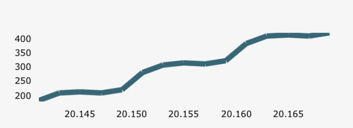

Any pointers on how to get my current line graph
Screen Shot 2018-04-20 at 14.38.34.png (34.8 KiB) Viewed 30894 times
Looking more like
Screen Shot 2018-04-20 at 14.40.31.png (46.02 KiB) Viewed 30895 times
Some questions:
1. Somehow I still see the marks on the line of the cross sections, so the line is not 1 smooth full color line
2. How do you enable the color fill from the bottom axes to the line?
3. Is there any graph touch interaction possible on the xamarin forms version, so that the user can move it's finger over the graph and we show a label at the mark selected?

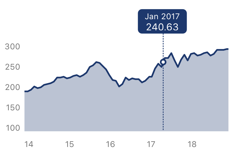

I've uploaded a similar example on our github account which includes all the functionality you were asking. You can find it here :
https://github.com/Steema/teechart-xama ... PointerSTD

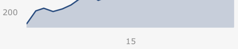

Only 1 small question still... if you look at my sample image, you will notice a 15 at the bottom.
This because I added DateTime values for the graph and set the Bottom Axes as follows:
AreaLineChart.Chart.Axes.Bottom.Increment = Steema.TeeChart.Utils.GetDateTimeStep(DateTimeSteps.OneYear);
AreaLineChart.Chart.Axes.Bottom.Labels.DateTimeFormat = "yy";
Now my question, although I increment per Year, the data also contains 2014 values. Can I make sure the left lower corner also has 14 visible?
Screen Shot 2018-04-25 at 10.47.12.png (13.93 KiB) Viewed 30832 times
Pep
Posts: 3318
Re: Line graph detail
Post by Pep » Fri Apr 27, 2018 1:51 pm
Hi Glenn,
some options here :
One way would by trying to add an extra offset for the bottom axis minimum and maximum :
chart.Axes.Bottom.MinimumOffset = 100;
If this doesn't help, you can also add custom axis labels manually , please take a look at the following post, and in the case you still having problems let me know, so we can try to find a solution :
http://www.teechart.net/support/viewtopic.php?t=8392

Post by Bank Van Breda » Fri Apr 27, 2018 2:25 pm
Awesome, bottom.MinimumOffset and MaximumOffset does the trick, thanks!
