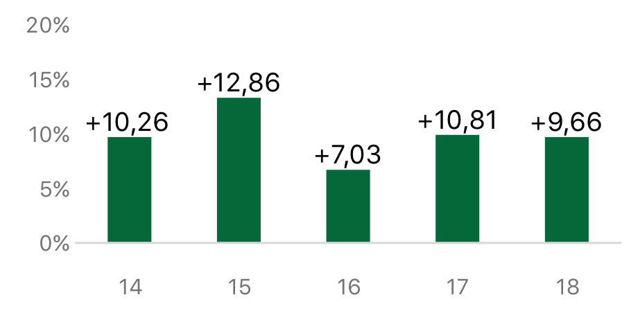

I'm trying to reproduce following designed version
DesignVersion

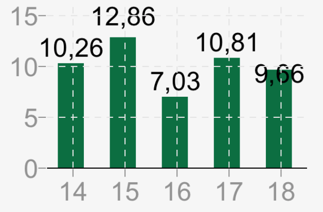

Current status
SteemaVersion
Screen Shot 2018-04-19 at 11.13.52.png (58.31 KiB) Viewed 26375 times

Some questions:
1. I'm unable to remove the grid dashes... tried Chart.Axes.Left.Grid.Visible = false without any luck
2. What is the best way to have tailored data labels that are different from the actual double values for the bar? So example show +10,26 instead of the real 10,26 value.
3. Same for the left labels, instead of 5 show 5%
4. Why aren't all bar labels 'above' the actual bar? ( cfr 9,66 label )

Hello Bank,
Sorry for the delay.
The code below shows you how can do all your request:
    ChartView tChart1;
		public MainPage()
			tChart1 = new ChartView();
			tChart1.Chart.Panning.Allow = ScrollModes.None;
			tChart1.Chart.Panel.Gradient.Visible = false;
			tChart1.Chart.Panel.Color = Color.White;
			tChart1.Chart.Walls.Back.Visible = false;
			tChart1.Chart.Header.Visible = false;
			tChart1.Chart.Legend.Visible = false;
			tChart1.Chart.Aspect.View3D = false;
			Steema.TeeChart.Styles.Bar bar1 = new Steema.TeeChart.Styles.Bar(tChart1.Chart);
			for (int i = 0; i < 5; i++)
				bar1.Add(i, i * 5);
			bar1.Color = Color.Green;
			bar1.Marks.Visible = true;
			bar1.Marks.Transparent = true;
			bar1.Marks.Pen.Visible = false;
			bar1.Marks.TailStyle = Steema.TeeChart.Styles.MarksTail.None;
			bar1.Marks.Arrow.Visible = false;
			bar1.Marks.Font.Size = 18;
			bar1.GetSeriesMark += Bar1_GetSeriesMark;
			tChart1.Chart.Axes.Left.Labels.Style = Steema.TeeChart.AxisLabelStyle.Text;
			tChart1.Chart.Axes.Left.Labels.Font.Size = 18;
			tChart1.Chart.Axes.Left.Ticks.Visible = true;
			tChart1.Chart.Axes.Left.MinorTicks.Visible = true;
			tChart1.Chart.Axes.Left.AxisPen.Visible = true;
			tChart1.Chart.Axes.Left.Grid.Visible = false;
			tChart1.Chart.Axes.Bottom.Grid.Visible = false;
			tChart1.Chart.Axes.Bottom.Labels.Font.Size = 18;
			tChart1.Chart.GetAxisLabel += Chart_GetAxisLabel;
			tChart1.Chart.Panel.MarginLeft = 20;
			tChart1.WidthRequest = 650;
			tChart1.HeightRequest = 350;
			Content = new StackLayout
				Children =
										tChart1
				VerticalOptions = LayoutOptions.CenterAndExpand,
				HorizontalOptions = LayoutOptions.CenterAndExpand,
		private void Chart_GetAxisLabel(object sender, GetAxisLabelEventArgs e)
			if (sender == tChart1.Chart.Axes.Left)
				if (e.ValueIndex != -1)
					e.LabelText = e.Series.YValues[e.ValueIndex].ToString() + "%";
		private void Bar1_GetSeriesMark(Steema.TeeChart.Styles.Series series, Steema.TeeChart.Styles.GetSeriesMarkEventArgs e)
			e.MarkText = "+ " + e.MarkText;
Hoping this works in your end, otherwise don't hesistate to contact us.
