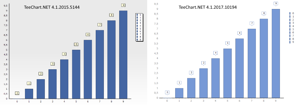

I added a few screenshots that make the comparison between the 2 versions of TeeChart.NET in different situations, visualizing the issues:
  • 'start_full_view.png' visualizes the starting situation for both versions, which looks ok for both versions. No issues here.

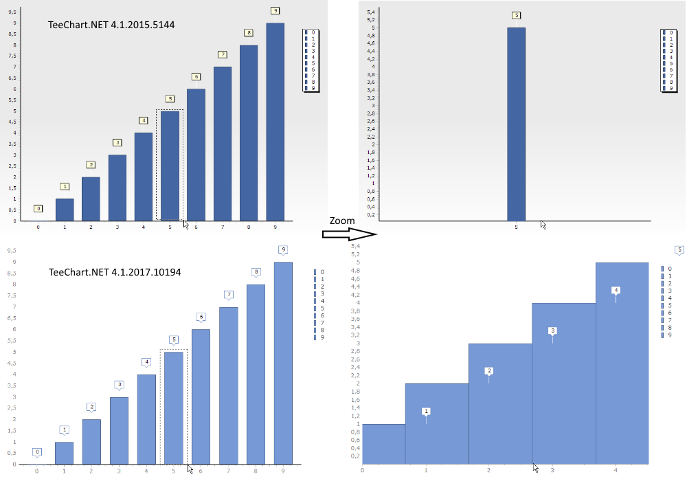

  • 'zoom_bar.png' visualizes the difference in behaviour when zooming in to 1 bar of the bar series. The old version nicely visualizes this 1 bar in the zoomed chart, keeping the bar width the same and restricting the horizontal and vertical axis range. The newer version unfortunately doesn't even show the 1 bar that is zoomed in, bars are way wider and overlapping other bars, and the horizontal axis range doesn't seem to be restricted correctly. The vertical axis range seems to be restricted correctly.

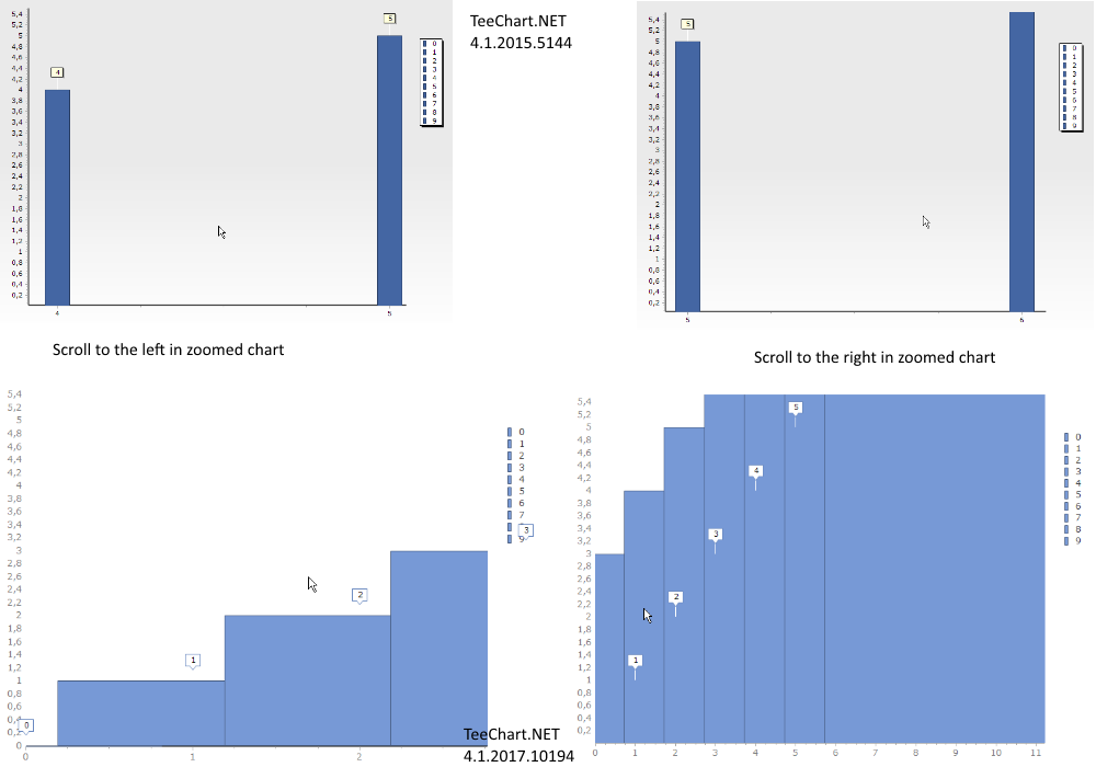

  • 'scroll_left_right.png' visualizes the difference in behaviour when scrolling horizontally through the zoomed chart. The old version nicely scrolls to left and right, keeping the same space between each data point and showing the previous and next bars of the bar series on the chart. In the newer version, it looks like only the end point of the horizontal axis can be influenced by scrolling, since the starting point always stays the same. As a result, when scrolling to the left in the newer version, the space between data points increases, and when scrolling to the right, the space decreases.

Many apologies for these issues, which I have been able to reproduce. It seems that the fixes to id=1636, id=1680 and id=1794 introduced these regressions. I will look at this problem now, but in the meantime I believe you should be able to return to previous rendering using a CustomBarWidth, e.g.
			Bar bar1 = new Bar(tChart1.Chart);
			bar1.FillSampleValues();
			bar1.SideMargins = false;
			bar1.CustomBarWidth = 50;
I have added these regressions to our issue tracker with id=2013 so you will be able to keep an eye on its progress.
