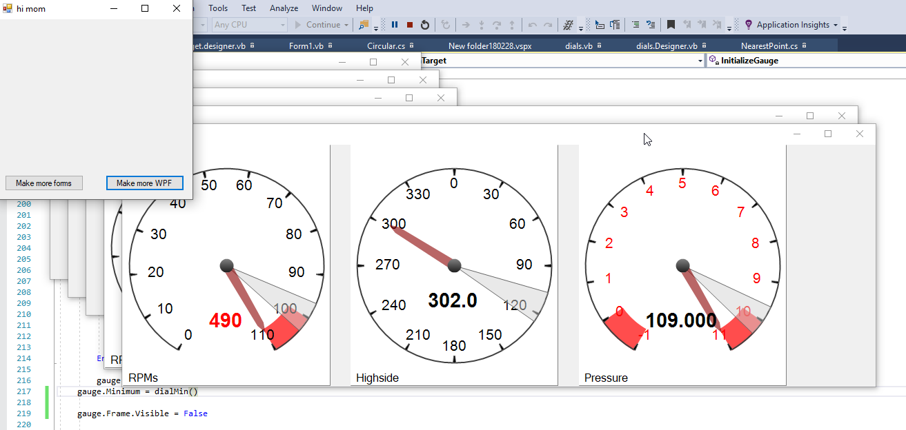

I've made a user control that represents the gauge I'd like to use. When I make, say, 10 instances of this control and attempt to update them every .4 seconds then systems.windows.forms.ni.dll uses 94% of my computer's CPU and only the form that has focus will actually update. If you prefer, it's steema.teechart.styles.cframe.draw sucking up 78%. Or, just below that, steema.teechart.drawing.graphics3dgdiplus.polygon with 47% and thus system.drawing.ni.dll 45%. Ahem!
So, as we covered last year, I'm doing AfterDrawValues, BeforeDrawHand and BeforeDrawValues.
AfterDrawValues: get the font, make and measure a string of the gauge value then resize and place accordingly
BeforeDrawHand: draw the target (as per http://www.teechart.net/support/viewtop ... 82&p=73820)
BeforeDrawValues: draw the red/green limit lines
Setting the needle value does a chart.invalidate and, again, this happens every .4 seconds.
So, anyway... Have any quick hints on speeding things up? Like, a lot, please. No, really, a lot a lot :)

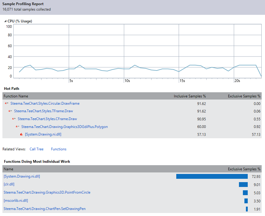

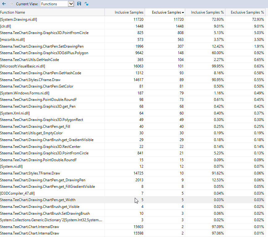

thank you for your example project. I have run this project and profiled the TeeChart.dll, the Windows Forms component, with these results:
looking more carefully at the functions I see this:
I see these results as expected. What these results state is that nearly three-quarters of the time needed for TeeChart to render is used by System.Drawing.dll, a .NET Framework assembly. Just over a quarter of the time needed to render TeeChart is used by functions written by Steema within the TeeChart code. This is expected because TeeChart is a visual component and as such is completely dependent on the bitmap rendering algorithms of the .NET Framework.

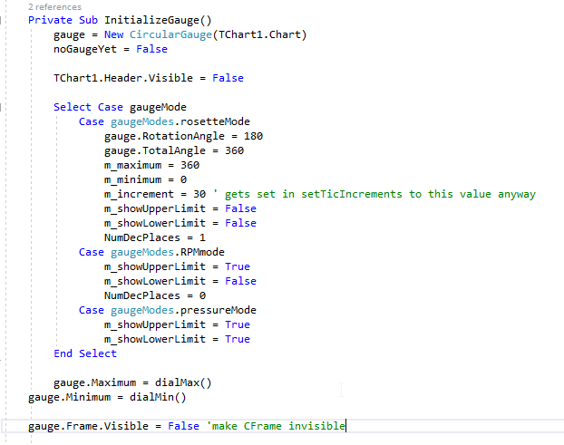

Basically, then, the less that is drawn onto the TeeChart the quicker it will render. One example of this is the CFrame you mention, which can be made invisible (and hence not drawn) with code such as the following:
the results of which look like this:

Edit: So... Do you have any other suggestions on performance? Taking the frame away makes things incredibly fast but visually things are a bit, um. How can I still have a full circle every time?

Looks like gauge.Frame.circled is really bad on performance and it doesn't appear to affect the end visual result - in this case.

So I have to ship. So what I did was to make the background of the Tchart a dark color and then I hide the frame. This is suboptimal but, hey, well, it does work, I suppose. And it performs.

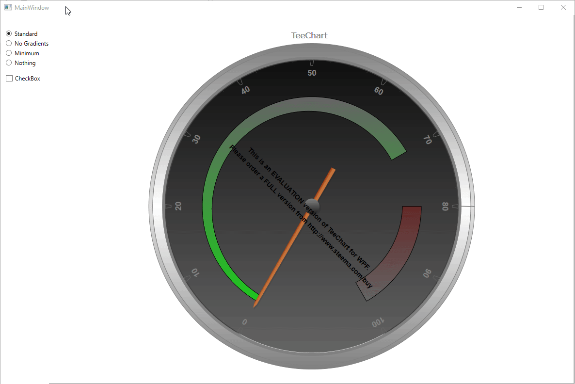

I've created a little WPF project for you showing the effect of drawing ever less elements onto the Chart:
http://teechart.net/files/public/suppor ... ProWPF.zip
here, in Release mode, the project runs like this:
Again, I see this performance as expected - the fewer the elements, and the lesser the rendering complexity of each element (e.g. Gradient etc.), the quicker the chart paints. Please bear in mind that in WPF the frames per second is not an accurate reflection of the number of bitmaps the WPF framework renders to the screen - we calculate the FPS by the number of parses made through the TeeChart drawing code, but as WPF uses a retained mode graphics system then this is not an accurate reflected of the actual framerate.
