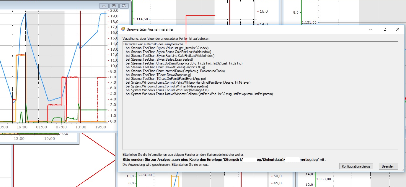

We get spurious error messages with "Index out of Bounds" Exceptions in Steema.TeeChart.Styles.ValueList
[img]TeeChartAbsturz-neueTeeChartVersion.png[/img]
We have an application that makes heavy use of background initialization and update of TeeChart Series.
:idea: Could it be that TeeChart ist not thread safe?

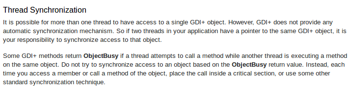

Wallenstein wrote: :idea: Could it be that TeeChart ist not thread safe?
It would be more accurate to say that GDI+ is not thread safe [from here]:
Screenshot from 2018-02-19 09-55-23.png (24.48 KiB) Viewed 16939 times
TeeChart has no automatic synchronization mechanism because GDI+ has no automatic synchronization mechanism, which means that if you are using a TeeChart object which refers to a GDI+ object in a multithreaded application you will have to 'place the call inside a critical section, or use some other standard synchronization technique.'

Wallenstein wrote: How can we ensure that TeeChart is not painting during an series update?
If the TChart object is running on the same thread as the Series object there is no problem. The problems occur when they are run on different threads. If this is the case, then updates to the Series object should be placed inside a critical section.

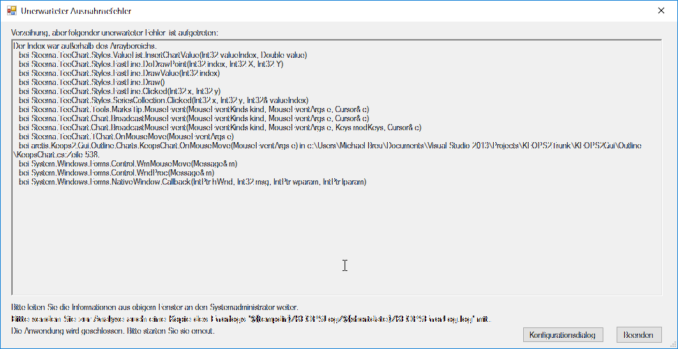

We have done various synchronizations in our applications. However we are still suffering from Index-Out-Of-Bounds problems:
As you see from this stacktrace, the FastLine Draw-Method is Inserting Values into the ValueList.
Why is it doing this? What points are here inserted? The FastLine was already be filled with all necessary points.
Best regards
Michael

Wallenstein wrote: Why is it doing this? What points are here inserted? The FastLine was already be filled with all necessary points.
the FastLine series fills an internal valuelist with values when its Clicked() method is called as a speed optimization, and this Clicked() method is called by the MarksTip tool. Just by looking at the code I can't imagine why it should fail, and certainly all the tests I've run on the code haven't caused it to fail in this way, e.g.
