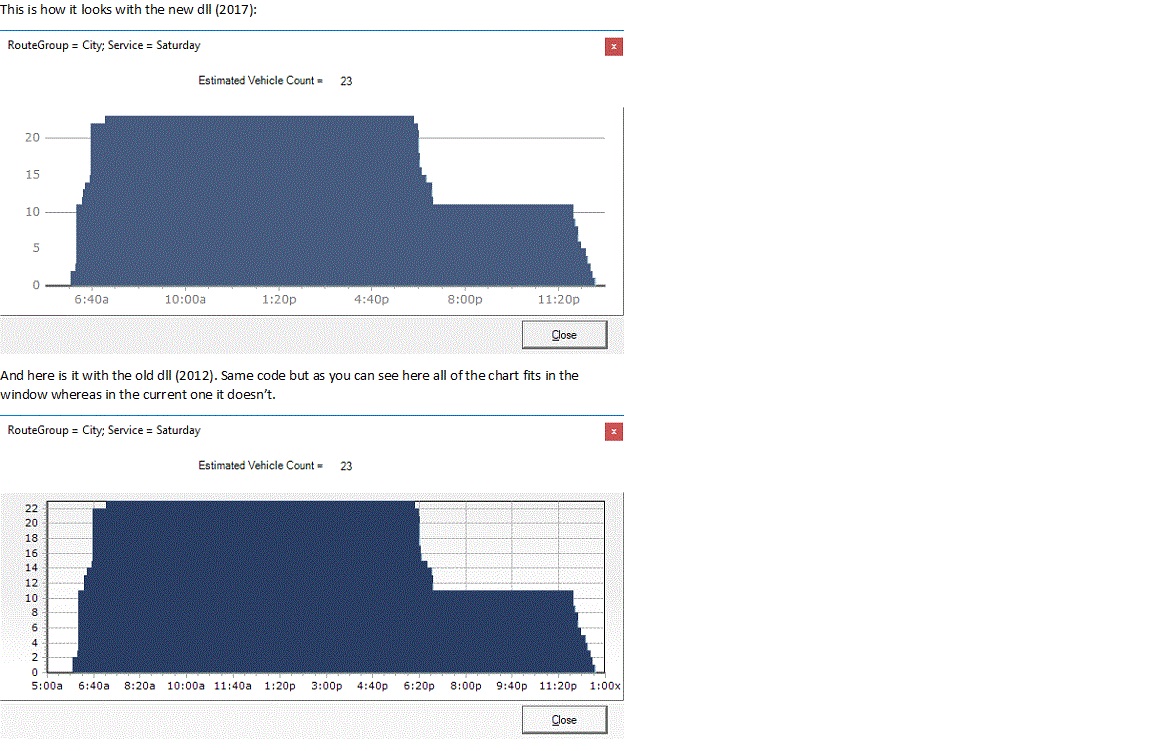

I investigated more and I think the reason I have to widen the form in order to make it work is because with the new dll it doesn't put the whole chart in the window whereas with the old one it does (the code doing this is the same). Is there a property or something else that has changed and I need to set in order to have it behave like before and have it work without needing to widen the form window?
Thank you,
Michael
P.S. Attached is an image with the 2 charts using the 2 versions of the dll.
Thank you,
Michael

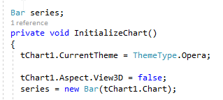

you can change the default theme back to the one that was default in the earlier version with code such as the following:

Hi Christopher,
I did the changes you suggested but it didn't help. I guess I will have to wait for a new release you mentioned that will have the fix.

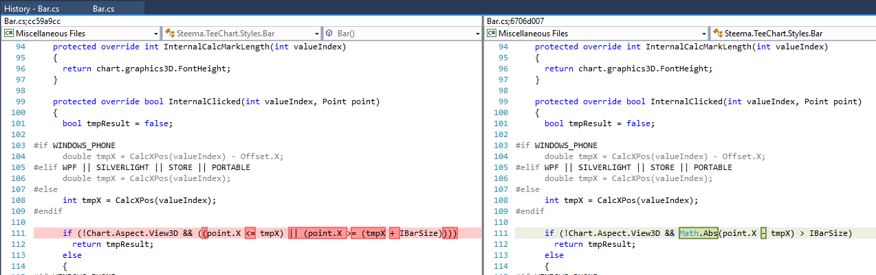

The fix is in the InternalClicked() method of the Bar class in Bar.cs:
if you use the HorizBar series a similar fix can be made there too.

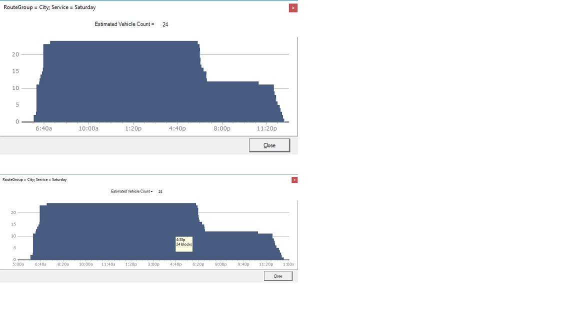

I made the changes to bar.cs and rebuilt the TeeChart45 project and now when I move the mouse on top of it it works fine, the tool tip I was displaying shows without needing to widen the form window. The only thing different is that it's still not showing all of it, the display is the same like before. The chart with the old dll shows the time until 1x (1am), the new one until 11:20pm.
Thank you,
Michael

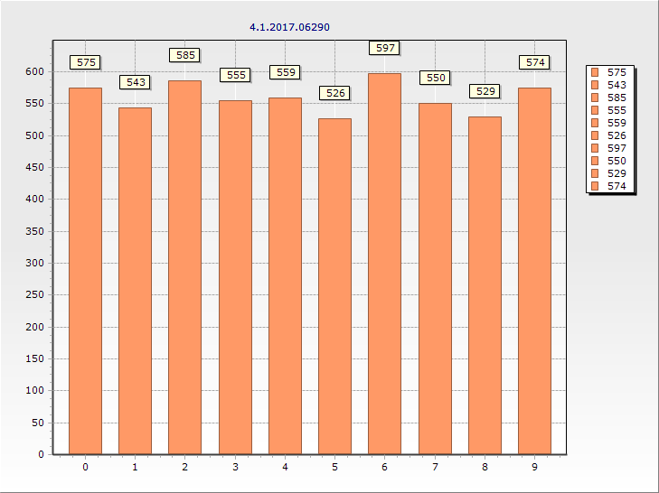

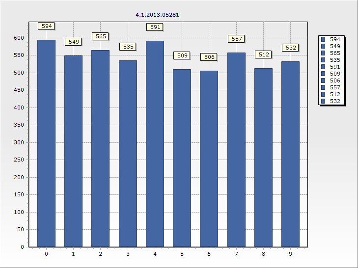

Try this code with your two dlls:
Here, with the latest dll and with one from 2013, I obtain the following:
in this scenario I cannot detect any difference in the increment between the labels on the left axis.
TChart tChart1;
Bar series;
private void CreateChart(bool usetheme = true)
tChart1 = new TChart(usetheme);
splitContainer1.Panel2.Controls.Add(tChart1);
Func<string> Version = () =>
string version = typeof(Chart).Assembly.GetName().Version.ToString();
if (version.Length == 13)
version = version.Insert(9, "0");
return version;
CreateChart(false);
series = new Bar(tChart1.Chart);
Random rnd = new Random();
for (int i = 0; i < 10; i++)
series.Add(rnd.Next(500, 600));
tChart1.Header.Text = Version();
Re: Clicked method of Series always returns -1
Hi Christopher,
My old dll is from 2012, not 2013. Is there a way to control the labels of the left axis?
Thank you,
Michael
