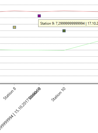

But whenever a point is added, the tooltip text will be shown on the corresponding X-axis.
(see picture where "Station 9" is getting overlayed from information)
overlay on the X-Axis with information from tooltip
How can I prevent the tooltips from being shown on an axis?

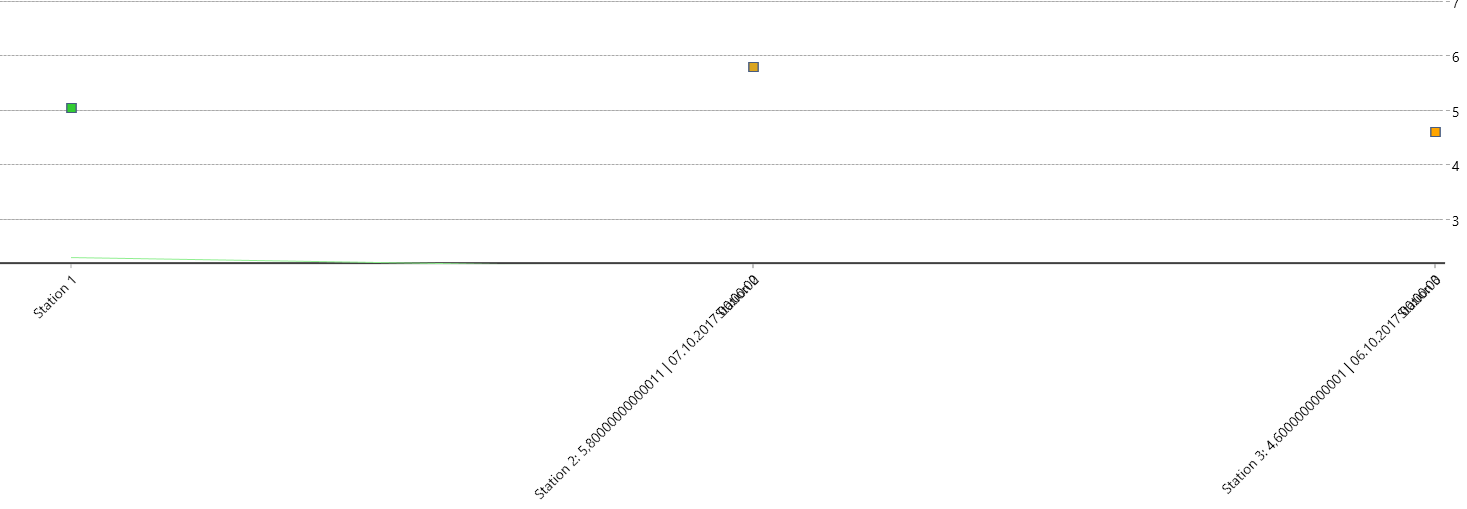

Additional curiosity I cannot resolve is seen in the two more pictures, attached.
Zoomed into the (same) chart - there are no tooltip information over the axis labels.
The same chart moved a bit to the right with panning, so the third point comes into the visible chart area - voilá tooltip information over the axis label.

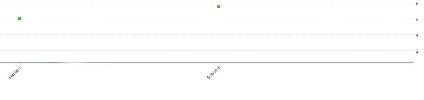

zoomed into the chart - panned to the right: tooltip information arise
one point more - with tooltips.PNG (20.54 KiB) Viewed 8649 times
zoomed into the chart - no tooltip information over
zoomed - no tooltips.PNG (5.74 KiB) Viewed 8644 times

Occasionally, since implementing your hint from topic "Displaying every label on X-Axis" the effect is not longer available.
foreach (DataRowView viewRowStation in viewStationTable)
//Create labels for stations on X_Axis
   Steema.TeeChart.WPF.AxisLabelItem item = MainChart.Axes.Bottom.Labels.Items.Add((int) viewRowStation.Row["StationID"], (string) viewRowStation.Row["StationName"]);
Probably there were a difficult mix of series, points, marks and lables TeeChart had to calculate for the X-axis labeling. With a manually added set of labels the calculation may freed up from this.
So, no need for further investigation here.
