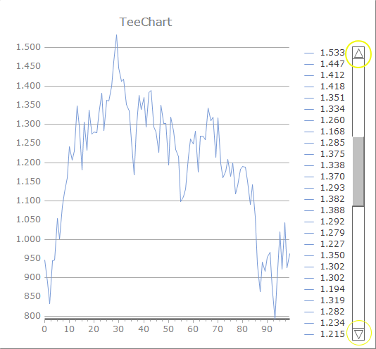

Re: Scrollbar components overlap
Post by Christopher » Fri Apr 07, 2017 8:34 am
biqpaulson wrote: Have you had a chance to look my comments below? Do you this it would be possible to resolve this issue?
Using the .NET 4.0 version of the TeeChart.dll from the latest version and the following code:
      Line series = new Line(tChart1.Chart);
      series.FillSampleValues(100);
      LegendScrollBar tool = new LegendScrollBar(tChart1.Chart);
I obtain the following:
from what I understand the problematic rendering should occur within the two yellow circles, but in my view the placement of the arrows seem correct, or rather, are symmetrical and non-overlapping.
