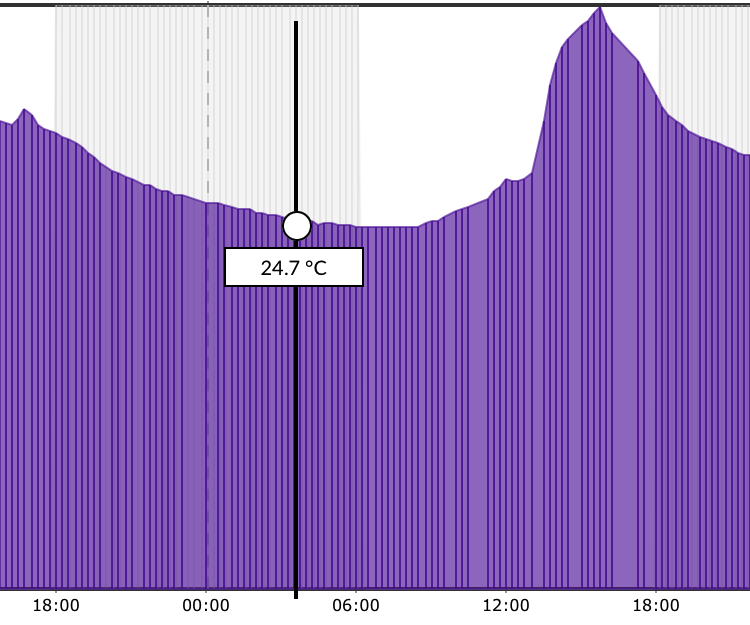

hi,
i am unable to get a proper transparency in my area?
I have tried setting it on the series and on the area and neither works.
if i use a argb color on the series it kinda works but then these lines show up and i cant hide them?
ie. series.Color = Color.FromArgb(58,214,214,214);
using TeeChart.iOS.Unified
4.16.6.20
Simulator Screen Shot 16 Feb 2017, 4.10.04 pm.png (36.48 KiB) Viewed 12022 times

Hello theyield,
I think can helpful for you combine the code below to resolve the problem you're experiencing:
area2.AreaLines.Visible = false;
area2.Opacity = 0;
area2.Transparency = 100;
area2.Color = Color.FromArgb(58, 214, 214, 214);
Hoping this helps you, otherwise don't hesitate to contact us.
Thanks in advance

Unfortunately this did not help to get rid of the vertical lines. Any other suggestions?

Post by Sandra » Tue Feb 21, 2017 9:14 am
Hello theyiedl,
I would like inform you, after doing some tests, we have added the problem you're experiniencing in Teechart.Net bugzilla tracker to fix it to upcoming versions. Here's the link: http://bugs.teechart.net/show_bug.cgi?id=1793
Feel free to add your mail to the CC list if the ticket to be automatically notified when an update arrives.
Thanks in advance
