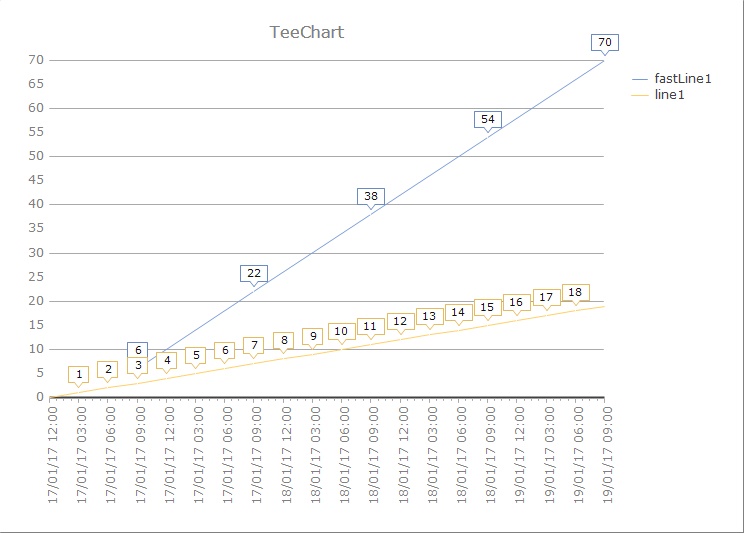

This class can be used as following:
    Line series;
    FastLine funcSeries;
    MyAdd chartTotalFunction;
      funcSeries = new FastLine(tChart1.Chart);
      funcSeries.Marks.Visible = true;
      chartTotalFunction = new MyAdd();
      chartTotalFunction.Period = new TimeSpan(0, 12, 0, 0).TotalDays;
      chartTotalFunction.PeriodAlign = Steema.TeeChart.Functions.PeriodAligns.Last;
      chartTotalFunction.PeriodStyle = Steema.TeeChart.Functions.PeriodStyles.Range;
      funcSeries.Function = chartTotalFunction;
      series = new Line(tChart1.Chart);
      DateTime today = DateTime.Today;
      for (int i = 0; i < 20; i++)
        series.Add(today, i);
        today = today.AddHours(3);
      series.Marks.Visible = true;
      funcSeries.DataSource = series;
      tChart1.Axes.Bottom.Increment = new TimeSpan(0, 3, 0, 0).TotalDays;
      tChart1.Axes.Bottom.Labels.DateTimeFormat = "dd/MM/yy hh:mm";
which gives me this chart:
The above chart is now correct. Can I help you with any specific questions you may have with this?

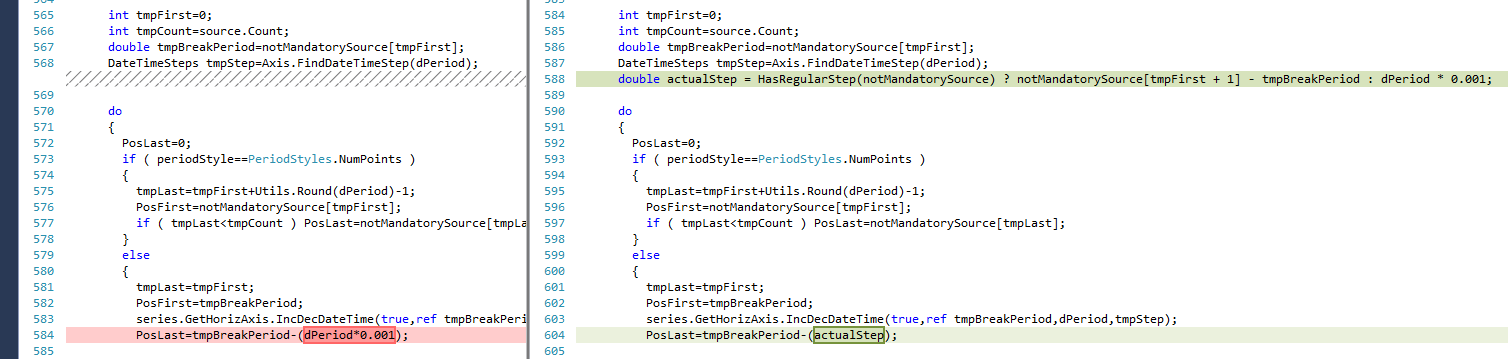

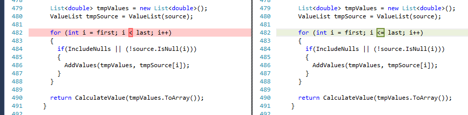

Of course. The changes are in Functions/Basic.cs:
You already have the code for HasRegularStep().

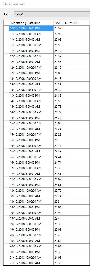

Screenshot for sample data
Sample data for the series

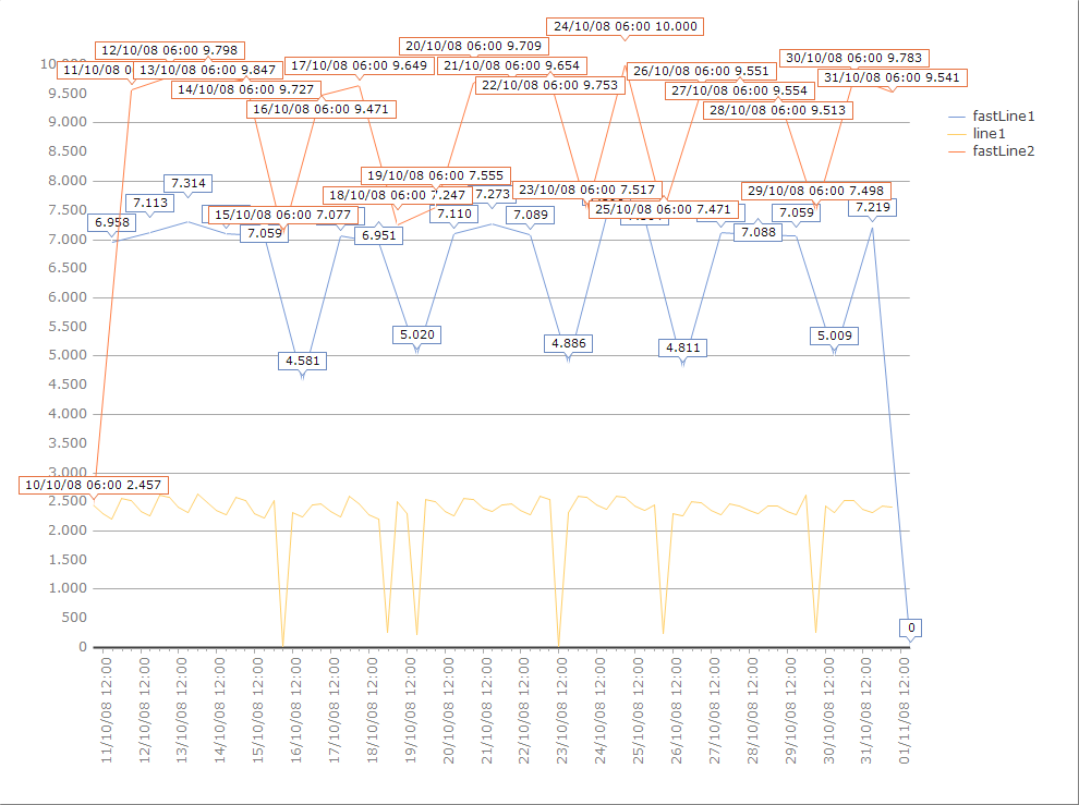

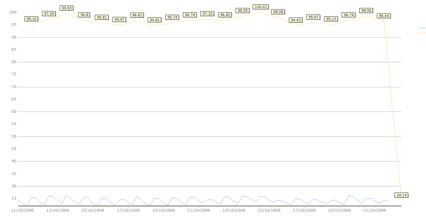

We are using with chart max and total functions.
Output for total function:
total function
Output for maximum function:
The results are correct when the subset of data for each day has the same number of data/ same interval (i.e date/time)

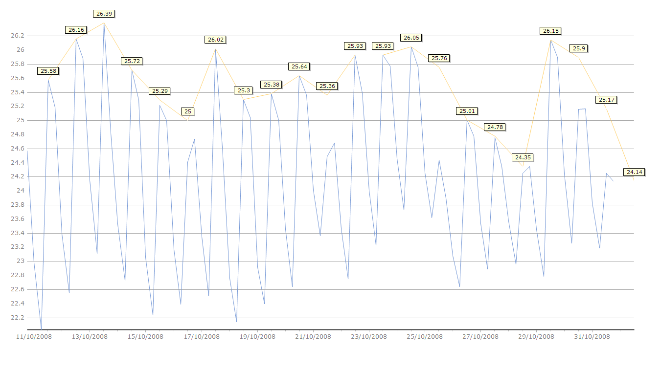

which gives me this:
In funcSeriesLINQ we group the data by the Date, that is, by a one day (24 hour) period whereby all points are of the same day. The funcSeries, on the other hand, groups points into one day periods but not of the same day, because the first point does not start at 00:00. This is by design, although maybe not what you were expecting.
Thanks Christopher, the issue is as you pointed it correctly, the first point does not start at 00:00. I have added an overloading function to the datetime increment which solves our problem.
Thanks heaps for your help. :D Cheers!
