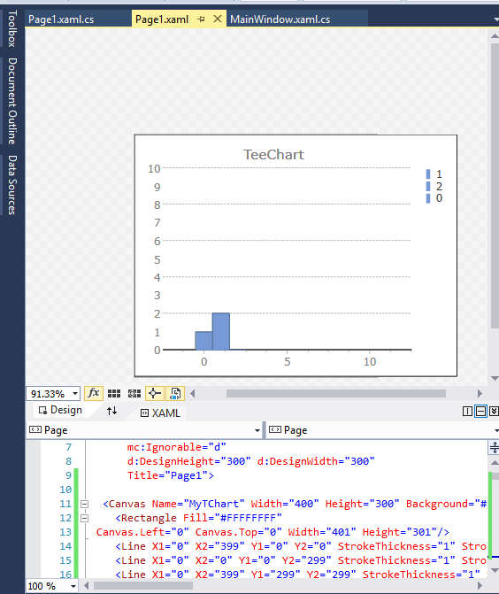

The following code:
		private void Button_Click(object sender, RoutedEventArgs e)
			Steema.TeeChart.WPF.Export.XAMLFormat xaml = MyTChart.Export.Image.XAML;
			xaml.Width = 400;
			xaml.Height = 300;
			xaml.Save(@"G:\temp\chart.xaml");
exports to file correctly. If I then copy and paste the canvas into a new Xaml page I obtain this:
