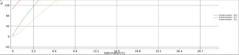

There is only one half of the graph in the exported image when first a pdf and immediatly after a png image is exported.
The exported pdf is right, but the png is drawn incorrectly. TeeChart .net version 4.1.2016.5122
Incomplete Graph of the png image:

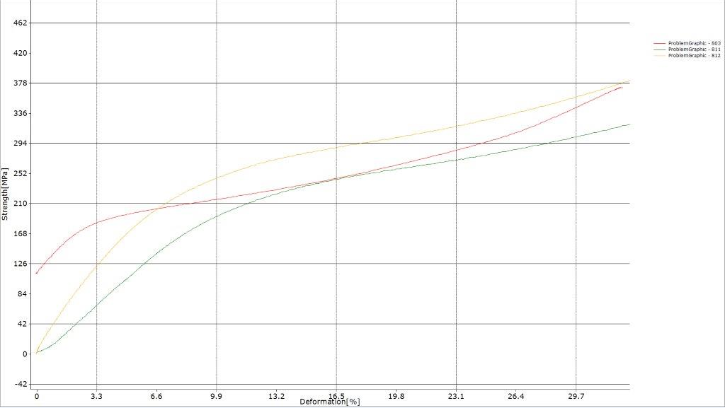

The graph should lik this
Complete Graph of the png image:
