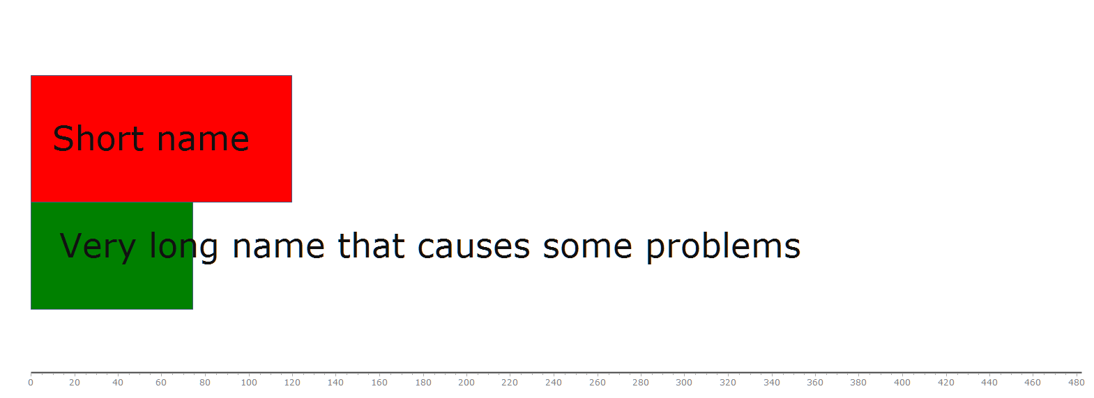

Thanks Sandra. That seems to sort basically sort it, but in my use case there is an issue that you should be able to see from the attached image.
The min and max are set to 0 and 120, but he graph is resized as if the marks are attached to the edge of the bar. When the label is longer than the screen the data entirely disappears.
Is there a way around this?

I don't think the problem is due to not being able to split the labels. The problem is that the size of the bar shrinks as the length of the mark grows. This makes sense when the label is on the end of the bar, but when it's at the beginning it's the wrong thing to do. In the image above, if I don't use a mark the axis is 0 -> 120 and the red value goes all the way to the end.
The extra whitespace at the end is the length of the largest mark. The end of the bar moves left as if it was allowing space for the mark to be drawn on the end.

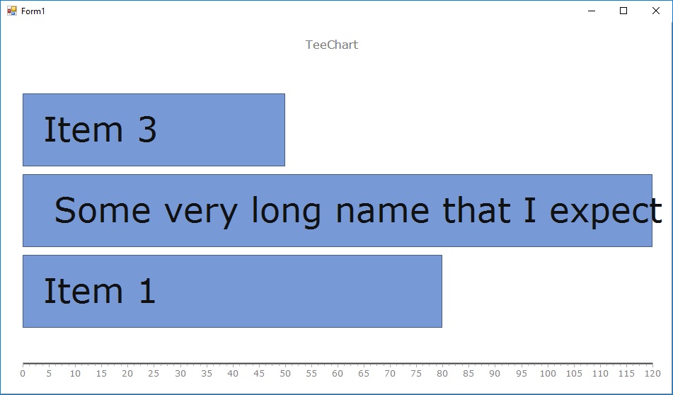

I would like inform, we have made some changes in our source code to fix the problem you're experiencing. We have gotten the results below:
Could you confirm if the above results are what you expect?
Thanks in advance for your help

That looks perfect, thank you very much.
