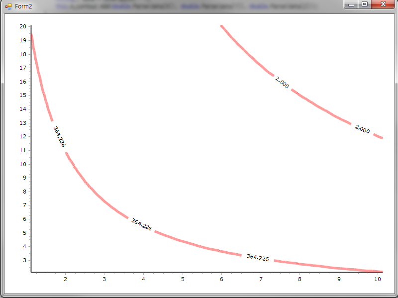

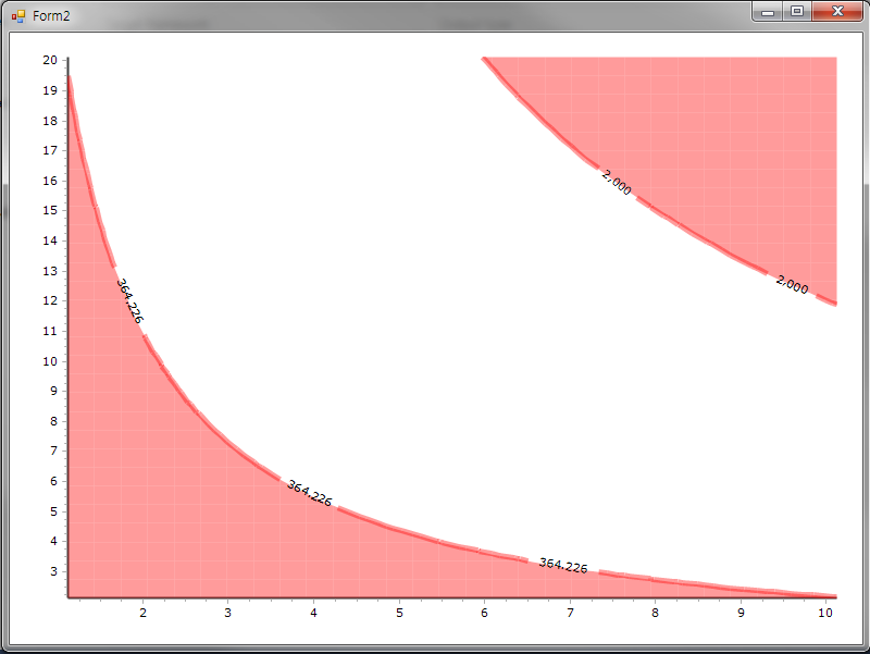

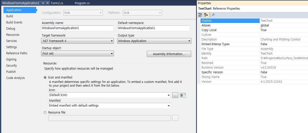

DEV1
Posts: 9
Joined: Wed Dec 02, 2015 12:00 am
Re: Surface Chart and Contour Chart Issues
Post by DEV1 » Wed May 11, 2016 5:53 am
I am attaching three screenshots to show the issue that you were not able to reproduce.
As I was watching your video, I noticed that the version you are using is not really the same.
A file named Version.png displays what is our T-Chart is as well as Target Framework.
A file named 364.2261.png displays a T-Chart with proper coloring when UpToValue is set at 364.2261.
A file named 364.226.png displays a T-Chart with improper coloring when UpToValue is set at 364.226.
I would like to investigate this matter further as it is very important for us to make sure that this behavior is never produced.
Thank you for your cooperation.

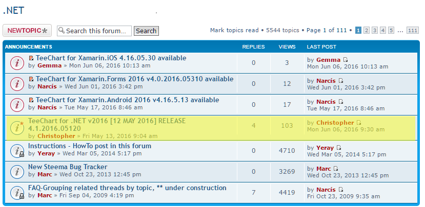

Post by Christopher » Tue Jun 07, 2016 9:30 am
DEV1 wrote:I am waiting for your next maintenance release. You told me that it would available in a few days.
I would like to know if the maintenance release is ready and it sure fixed the problem that I mentioned.
Please let me know as soon as possible as we need to update out software as quickly as possible.
The new maintenance release was announced nearly a month ago at the top of this forum, as you can see here:
I can affirm that a fix to your issue is included in this release.
