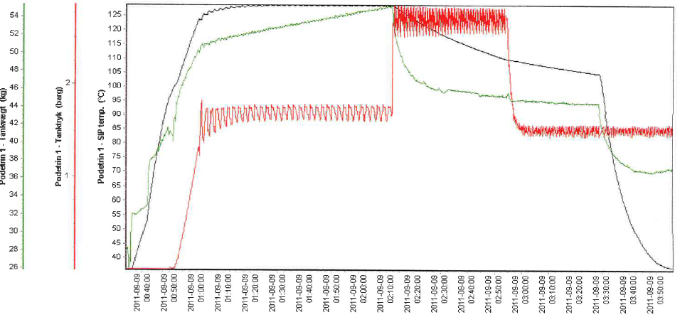

The issue is starting position of X-axis and Y-axis values. I would expect the chart as per attached. Also, the code I tried is in tChart1_AfterDraw method.

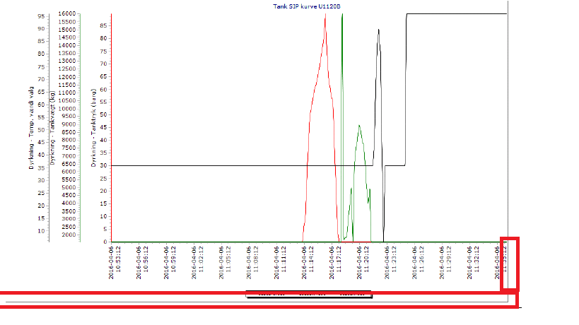

Need your inputs on removing the border (bottom line) marked in attached screenshot (Trend_chart1). We need the border to just chart area as attached in screenshot (Trend_chart2)
Re: Bottom and Custom Vertical Axis Label Start Position
Post by Christopher » Wed May 25, 2016 3:21 pm
Priyanka wrote: Thanks. It solved both issues :)
You're welcome, I'm very glad to hear it!
Priyanka wrote: Need your inputs on removing the border (bottom line) marked in attached screenshot (Trend_chart1). We need the border to just chart area as attached in screenshot (Trend_chart2)
You can try:
WebChart1.Chart.Panel.Bevel.Inner = BevelStyles.None;
WebChart1.Chart.Panel.Bevel.Outer = BevelStyles.None;

Post by Priyanka » Thu May 26, 2016 9:10 am
Hi Christopher,
I tried it but no luck.
