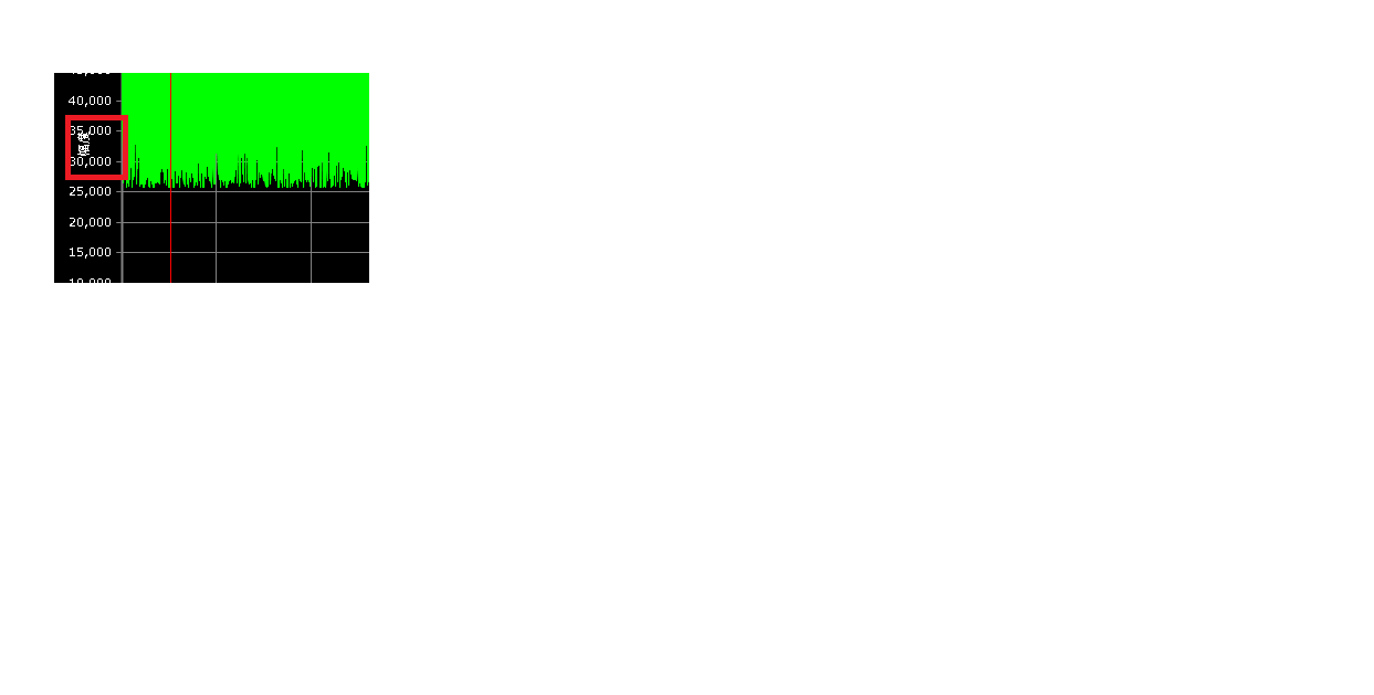

Frist,Look the picture axis labels and title overlaping for many vertical axes.I want title on the left all the time,What should I do ?

Chinfot wrote: Frist,Look the picture axis labels and title overlaping for many vertical axes.I want title on the left all the time,What should I do ?
You can use the CustomSize property, e.g.
      tChart1.Axes.Left.Title.Text = "Left Title";
      tChart1.Axes.Left.Title.Angle = 90;
      tChart1.Axes.Left.Labels.CustomSize = 100;
