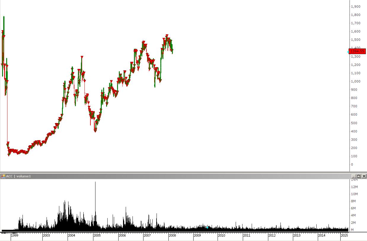

1) when I convert candle series to Kagi it compresses to half of timeline. can you give solution to make it as per datetime bottom axis.
2) also when I revert series type to candle with Series.ChangeType it doesn't clear Kagi series.

and what about compression irrespective of X Axis. i.e. value of 2015 is shown at 2007.
