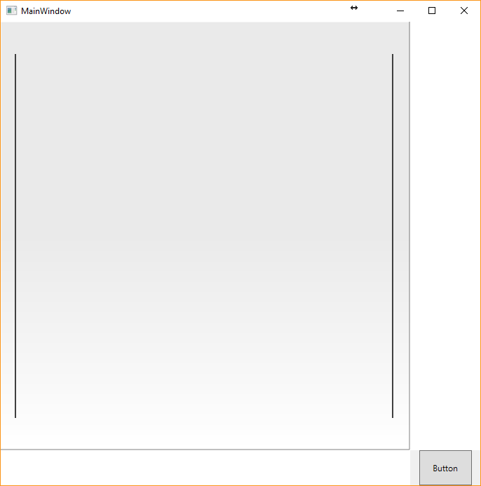

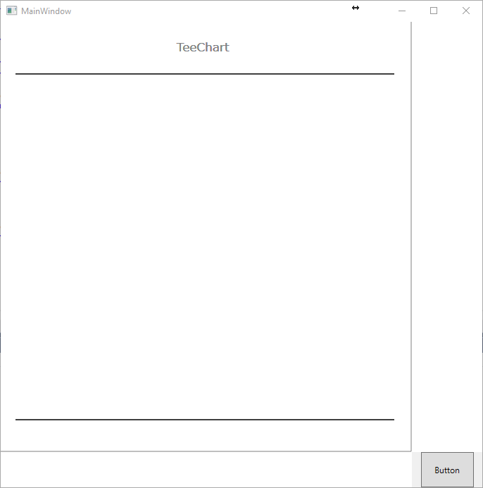

Using the following code with TeeChart.WPF.dll v.4.1.2015.12160
    private void InitializeCharts()
    private void button_Click(object sender, RoutedEventArgs e)
      tChart1.CurrentTheme = ThemeType.Opera;
      tChart1.Header.Visible = false;
      tChart1.Axes.Left.Visible = true;
      tChart1.Axes.Left.AxisPen.Visible = true;
      tChart1.Axes.Right.Visible = true;
      tChart1.Axes.Right.AxisPen.Visible = true;
I get the following two images:
and
do you get the same results?

Using your example, I get the same results.
I can also make the bottom and top axes appear by setting .Visible and .AxisPen.Visible to true for those axes.
But if I now add a series (e.g. FastLine) to the chart, the right and top axes disappear again.

Re: Controlling Header/Axis visibility
Post by Christopher » Fri Apr 01, 2016 8:43 am
AuerAhellwig wrote: But if I now add a series (e.g. FastLine) to the chart, the right and top axes disappear again.
To get those axes to display they need to be associated to a series, e.g.
      line.HorizAxis = HorizontalAxis.Both;
      line.VertAxis = VerticalAxis.Both;
