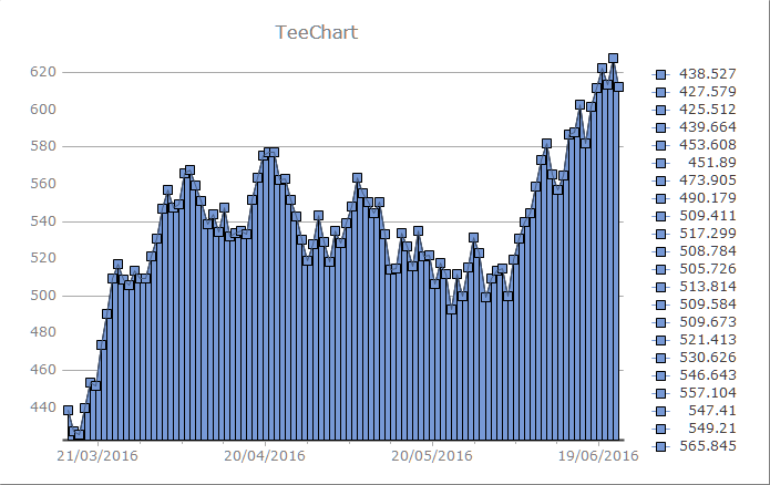

Quant wrote:while converting series to area chart control is crashed.
I am using following code.
Using that code I cannot reproduce the problem here, and the result I obtain is the following:
Which version of TeeChart.dll are you using?
