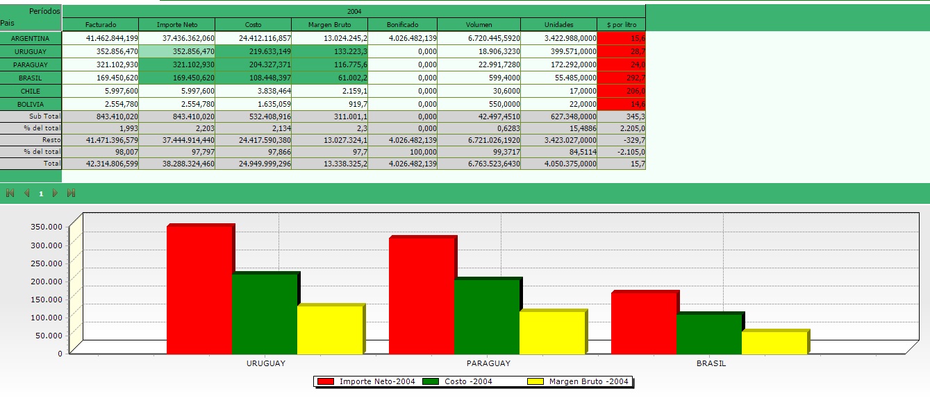

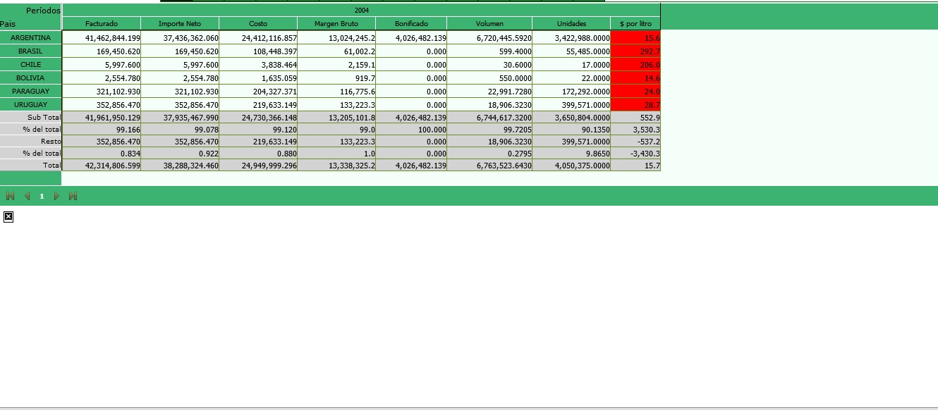

- IE 11
- IE11.jpg (139.29 KiB) Viewed 11773 times
- In Chrome
- ThreePoints.jpg (197.05 KiB) Viewed 11764 times

Hi, the version was the immediately before, we always update when an update arrived.
Because we needed to make a demo, I discovered that when there is not a connected net on the notebook, the problem not exists.
Is something with the image temporary directory, but I don't figure what.
