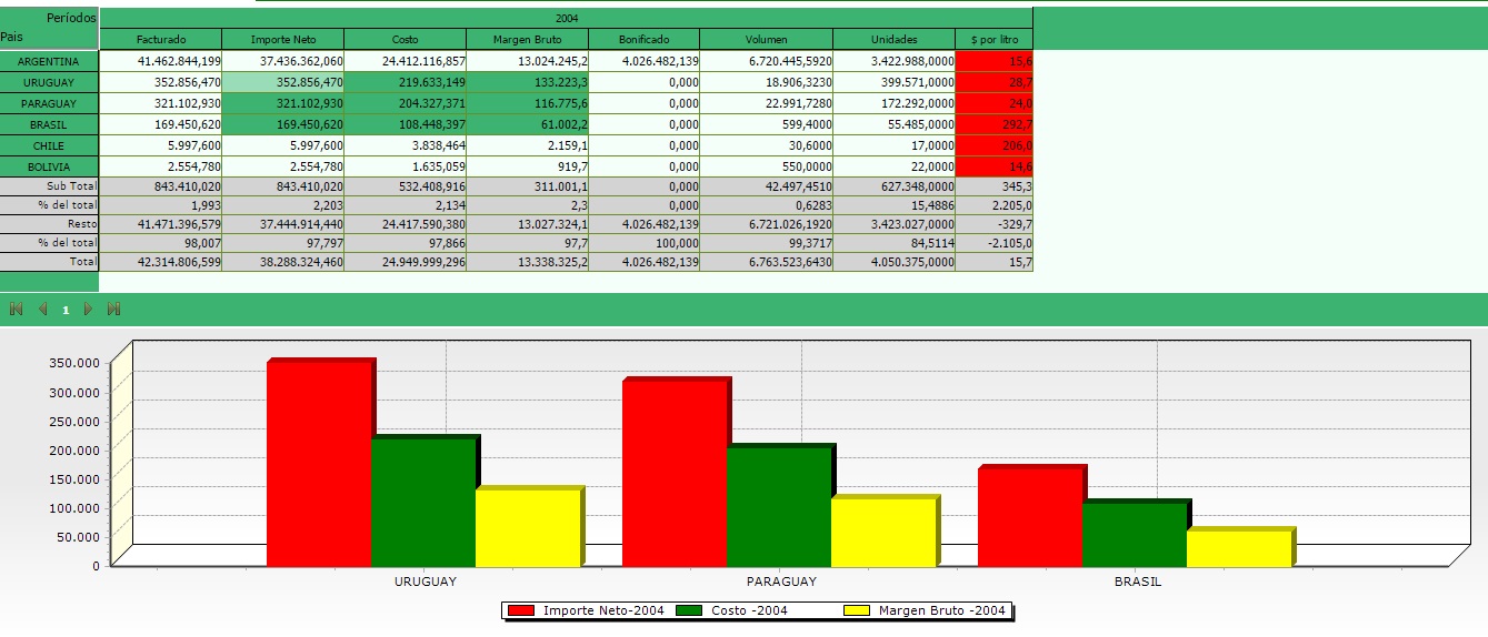

Hi, when show two points, the las bar of first point and the last of the first are drawn one over the other in part. This doesn't occur with three points.
With two points
With two points
With three points

Hermes wrote:Hi, when show two points, the las bar of first point and the last of the first are drawn one over the other in part. This doesn't occur with three points.
Would you please be so kind as to post here a Short, Self Contained, Correct (Compilable), Example with which we can reproduce your issue?

Solved with:
Steema.TeeChart.Styles.Bar lEstiloSerieBarra = new Steema.TeeChart.Styles.Bar(mGrafico.Chart);
lEstiloSerieBarra.BarWidthPercent = 60;
