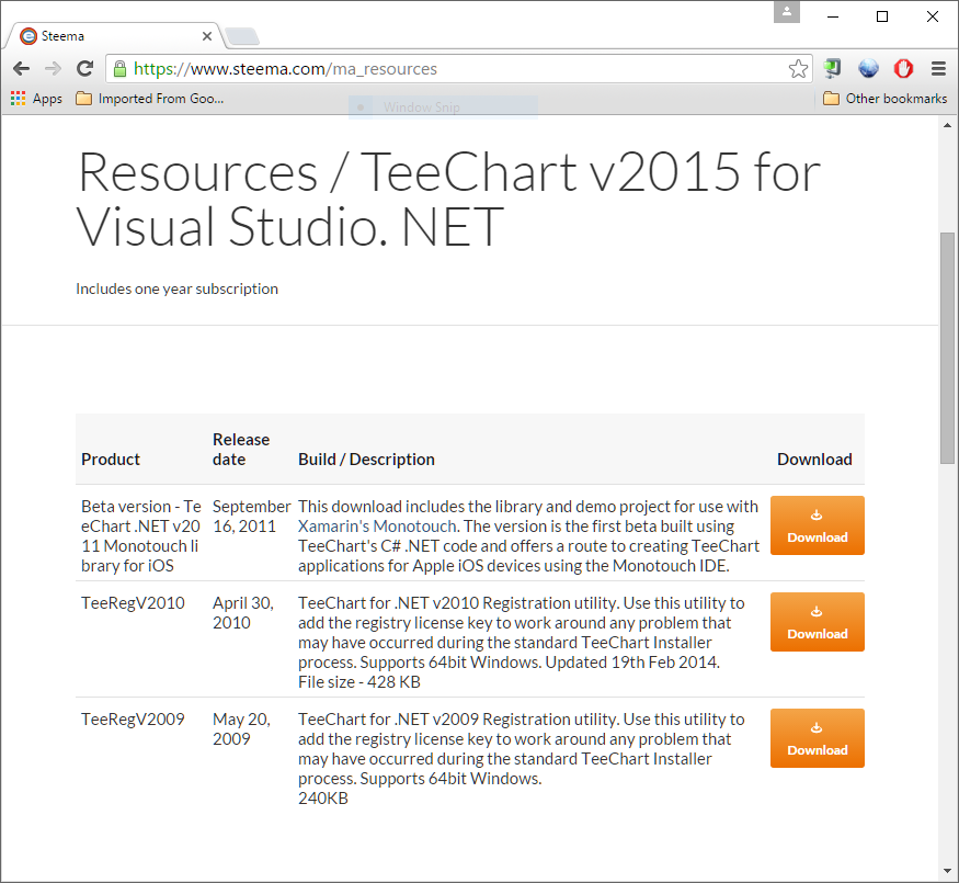

The issue could be one of registry entries on a 64-bit machine ... there's a little resource tool you can down load from the Client Access area of http://www.steema.com:
My suggestion is that you download TeeRegV2009 and run it on your development machine, then re-open Visual Studio and build your application again. Then try copying the files onto the other machine and seeing if they run. If they don't, try running TeeRegV2009 on the other machine too just to test.
