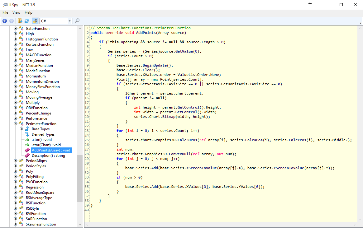

The clearest example of the use of the ConvexHull function within the TeeChart code itself is in the Perimeter function, an example of which is in the feature demo:
%PROGRAMFILES(x86)%\Steema Software\Steema TeeChart for .NET 2015 4.1.2015.12160\Examples\DemoProject\bin\ExecutableDemo\TeeChartNetExamples.exe
All Features -> Welcome !\Functions\Extended\Perimeter
You can see its use in the source code using a .NET reflector, e.g.
