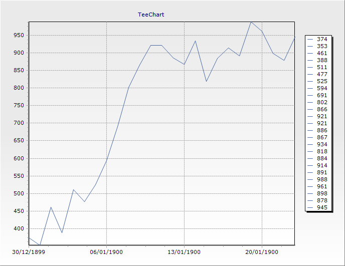

Using this code:
    Line line1;
      line1  = new Line(tChart1.Chart);
      line1.FillSampleValues();
    private void checkBox1_CheckedChanged(object sender, EventArgs e)
      line1.XValues.DateTime = checkBox1.Checked;
when checkBox1.Checked is true I get the following chart:

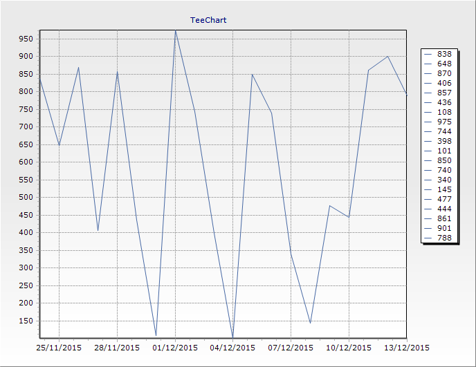

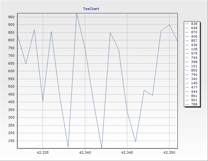

This could be similar to the problem you are getting. Using this code:
    Line line1;
      Random rnd = new Random();
      DateTime today = DateTime.Today;
      for (int i = 0; i < 20; i++)
        line1.Add(today, rnd.Next(0, 1000));
        today = today.AddDays(1);
I get the following chart with checkBox1.Checked = true:
and the following chart with checkBox1.Checked = false:
