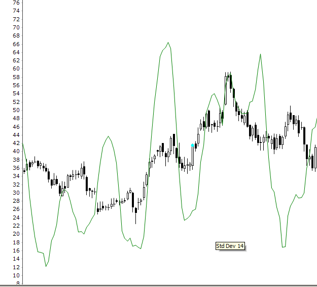

We want to show Series Title as a ToolTip when mouse cursor gets positioned onto Series. But we haven't found event for Series.MouseMove event. Instead we get Series.MouseEnter event, which shows the tooltip but the position of tootip is not as per the Mouse Position.
Check the below screenshot for more explanation.

As shown in the screenshot we are having more than 1 series plotted on the Chart. Using this way we have to select teechart series first then we have to assign it to MarkTips tool, which is not as per the requirement. We need this to work on mousemove event of Series or TeeChart.
