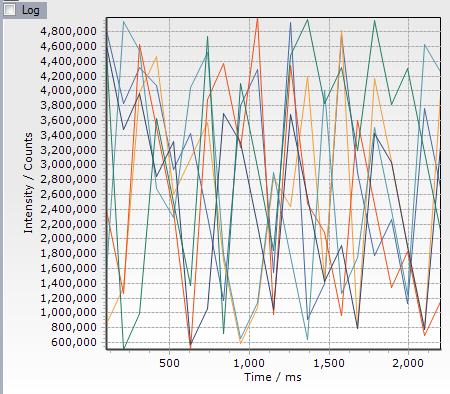

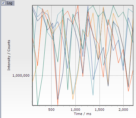

I can change Y axis to a logarthmic scale by doing;
However the axis only shows 1 label. See the 2 attached screenshots for a linear scale chart and the corresponding logarithmic scale chart.
I searched the forum and I found you can do;
tChart.Axes.Left.Increment = 100;
This improves things a bit with more labels displayed. However depending on the Y-axis scale, often there are too many labels and they overlap.
Is there a way to calculate the Increment (perhaps based on the max and min Y values in the chart?) such that a reasonable number of labels (that do not overlap!) are displayed.
Thanks!
chart with logarithmic scale
chart with normal linear scale

Dave wrote:s there a way to calculate the Increment (perhaps based on the max and min Y values in the chart?) such that a reasonable number of labels (that do not overlap!) are displayed.
An example here uses scrolling ... run the following code and then scroll the chart vertically (right-button mouse click and drag down):
      Random rnd = new Random();
      for (int i = 0; i < 5; i++)
        tChart1.Series.Add(typeof(Line));
        for (int j = 0; j < 50; j++)
          tChart1[i].Add(rnd.Next(10000, 1000000));
      tChart1.Scroll += TChart1_Scroll;
    private void TChart1_Scroll(object sender, EventArgs e)
      double range = tChart1.Axes.Left.Maximum - tChart1.Axes.Left.Minimum;
      range /= 10000;
      int div = (Utils.Round(range) / 100) * 100;
      tChart1.Axes.Left.Increment = div;
This can be modified to account for scrolling vertically upwards and for other similar circumstances.
