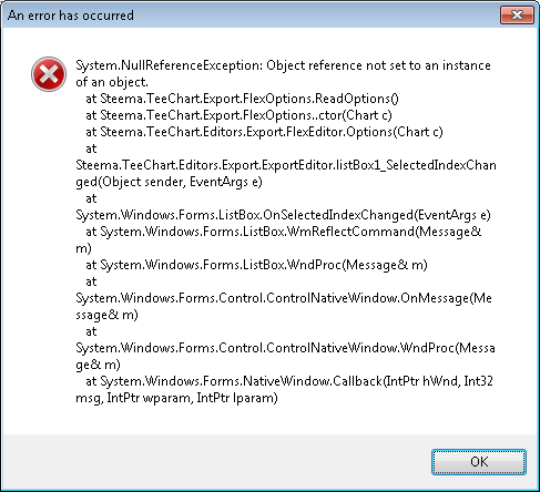

I am getting a crash when trying to use the save function from TeeCommander on a plot.
When the TeeChart Export dialog appears
Click on as "XAML (WPF)" and "as Flex (Flash)" and again click on "XAML (WPF)" which crashes the application.
Please see the attached image to see the crash report.
This is using Teechart.Net version 4.1.2014.08120
Any suggestions?
Crash when using TeeChart Export
- crash report
- ExportCrash.png (17.5 KiB) Viewed 9733 times

I think that's because the Flex (Flash) editor maybe be trying to write to the registry, for which it will need Administrator privileges under some security configurations. If you run your *.exe "Run as administrator", does it give you the same error?EdMike wrote:Any suggestions?

I do get something different, my crash is a NullException not an access issue. Please note I don't have the TeeChart development setup installed on this test machine, it is being used as a runtime only for displaying plots within our package.

You're right, I was looking at the wrong registry entry. I've found and fixed the defect. Pressing the Save button, without first having compiled the project (in the absence of the Flex compiler), simply saves to file a text-based *mxml file. This fix will be in the upcoming maintenance release, due out very shortly.
