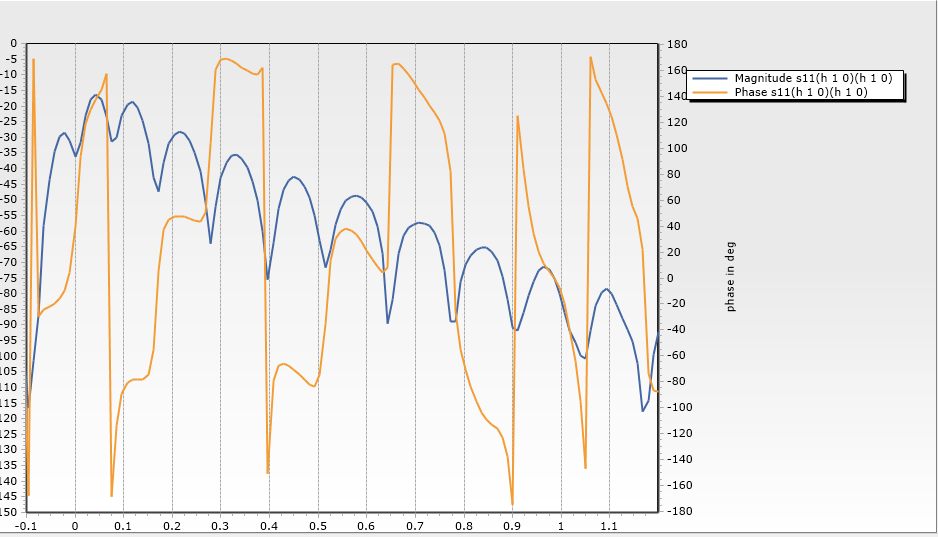

Raavi
Posts: 36
Joined: Tue Apr 01, 2014 12:00 am
Re: Magnitude and Phase plots
Post by Raavi » Thu Mar 05, 2015 3:32 pm
Thank you very much indeed.
I'm working with custom axis for bottom, right and left and they work really well except with the margins and axis title.
Attached the screen-shot of the same. May I Know how to give nice margins and axis title with custom axis?
Post by Christopher » Fri Mar 06, 2015 10:24 am
Raavi wrote:Attached the screen-shot of the same. May I Know how to give nice margins and axis title with custom axis?
Of course. You can use the Labels.CustomSize and the Panel.MarginLeft, as shown below:
