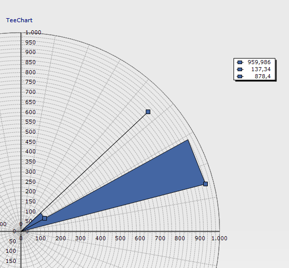

I have made some modifications to the source code so that this code:
      tChart1.Aspect.ClipPoints = false;
      Rose rose = new Rose(tChart1.Chart);
      rose.Circled = true;
      rose.CloseCircle = false;
      rose.GetVertAxis.SetMinMax(0, 1000);
      rose.Add(14.4, 959.986);
      rose.Add(28.8, 137.34);
      rose.Add(43.2, 878.4);
now gives this:
I think this should be enough to see what is happening here ... for each slice that is drawn, the position of the last slice is not possible to determine if the slices do not form a complete circle. This is because the slice is a polygon drawn from the first point to the second and so on.
If you think that this source change is sufficient, that with CloseCircle the Chart draws as shown, then I will mark it for production code.
