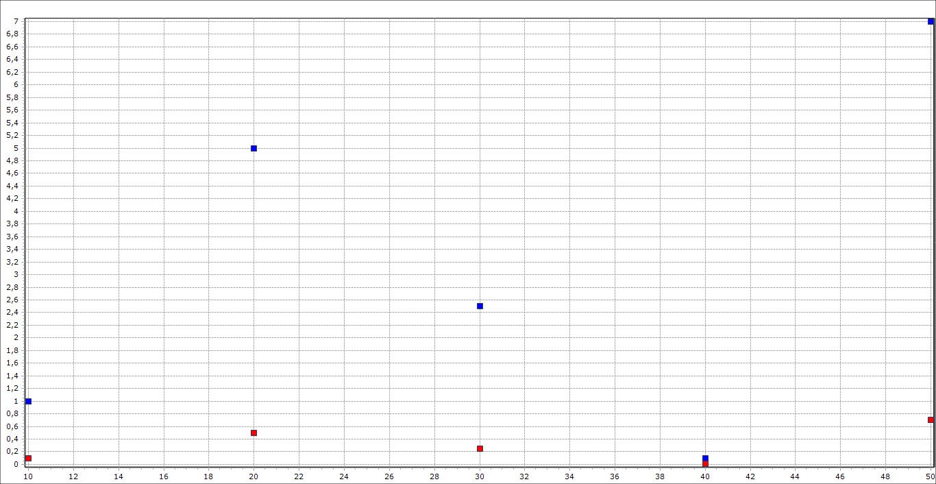

I have tried to make the following test case. As you can see in the example, the right axis "disappear" and cannot be seen - nor can the title be seen.
Further below I have tried to translate the code "PlaceAxes" from Delphi to .NET - I was given this code from Narcis wrt. Delphi and placing axes. I have not been able to translate and the debugger gives many errors - I need you help to translate this code in order for me to solve the problem with the custom axes

I have added a photo of the graph here where you can see the incorrect positioning of the right axes ;-)
