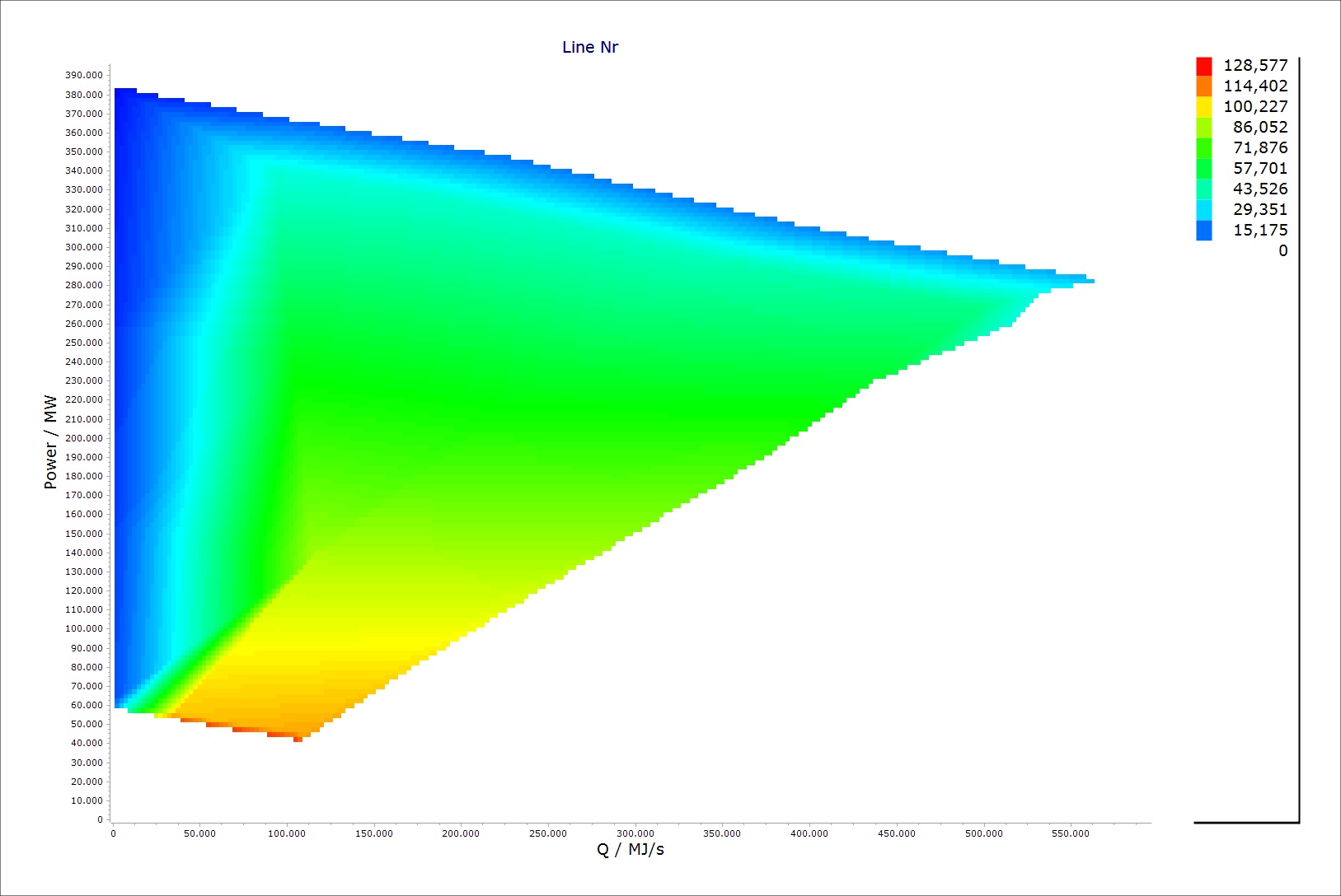

1) How do I get the legend to span the entire ChartRect.Height? as shown in the attached graphs, it only spans the top of the chart?
2) How do I format the legend text so that it becomes - for instance - 128,6 instead of 128,577 ??

1) This does not solve the problem - try to test the code I have made below on your system - can you reproduce the problem?

1) Perhaps I'm not explaining the problem well enough. The blue squared symbol with a value of 15.175 in the attached image "unknown.jpeg" - I would like to have that moved down to the very bottom and the red squared symbol with a value of 128.577 to stay at the top. In that way do make the legend values show a larger range of values and colors

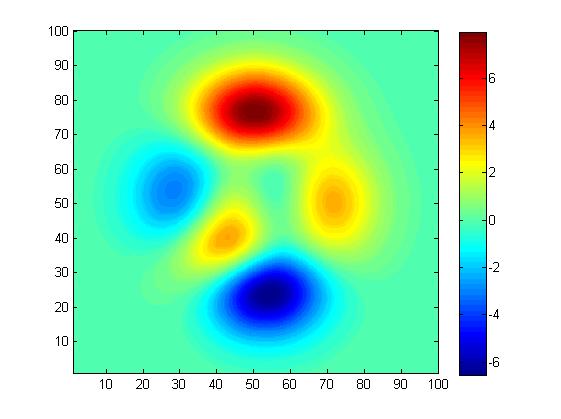

But, for instance, in the attached image "unknown.jpeg" there are 10 symbols ranging from 0 to 128.577 - isn't it possible to increase this number to a larger number so that you accomplish a smoother gradient and larger gradient?
for instance, in the attached image "untitled.jpg" the legend is very smooth and there are an "unlimited" amounts of symbols ??

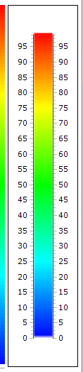

You'd better use LegendPalette tool for that. You'll find an example at "All Features\Welcome !\Tools\Legend Palette" in the features demo available at TeeChart's program group. This applied to your example:

That looks MUCH better - Thank you ;-)

legendPalette1.Transparent = false;
this looks strange - the font at the legend palette looks bold ??

Re: Legend with Continous = true and formatting of legind text
Post by Narcís » Fri Oct 17, 2014 1:56 pm
Hi Friis,
This looks like a bug to me. I have added it (ID971) to the bug list to be fixed for future releases.
Friis
Posts: 26
Joined: Thu Oct 16, 2014 12:00 am
Post by Friis » Sun Oct 26, 2014 7:53 pm
Hi Again,
How do I add a title to the legendPalette?
The following code does not work?
legendPalette1.title.text = "sasasf";
and
legendPalette1.chart.header.text = "dsf";
just adds a title to the chart itself ?
Post by Christopher » Mon Oct 27, 2014 9:33 am
Narcís wrote:This looks like a bug to me. I have added it (ID971) to the bug list to be fixed for future releases.
Yes; in the meantime, a simple workaround is this:
      tChart1.Series.Add(new ColorGrid()).FillSampleValues();
      Steema.TeeChart.Tools.LegendPalette legendPalette1 = new LegendPalette(tChart1.Chart);
      legendPalette1.Series = tChart1[0];
      legendPalette1.Axes.Chart.Graphics3D.TextRenderingHint = System.Drawing.Text.TextRenderingHint.SystemDefault;
      legendPalette1.Transparent = true;
Post by Christopher » Mon Oct 27, 2014 9:38 am
Friis wrote:just adds a title to the chart itself ?
Try:
      legendPalette1.Axes.Chart.Header.Visible = true;
      legendPalette1.Axes.Chart.Header.Text = "asasas";
Post by Friis » Mon Oct 27, 2014 9:47 am
Just implemented both of the solutions you have presented here - it works fantastic both of them - thank you ;-)
