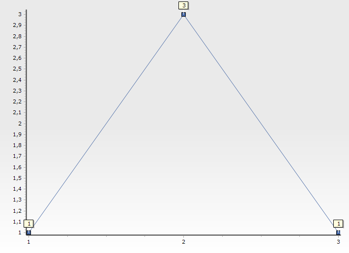

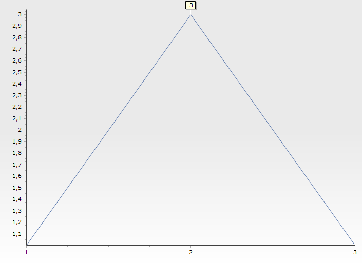

When a chart doesn't use Pointers, the MarksTips of the first and the last datapoint are not displayed:
However when Pointers are enabled, all of the MarksTips are also displayed correctly:
Is there a way to also show all MarksTips, when the Pointers are not visible?

Hello!
Yes, I think you should be able to set SoftClip to false, e.g.
      Line line = new Line(tChart1.Chart);
      line.Marks.SoftClip = false;
      line.Marks.Visible = true;
      line.FillSampleValues(3);
