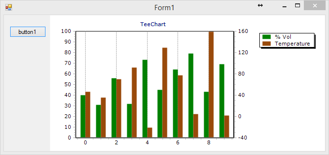

Re: Using none zero Origin on a bar series.
Post by Christopher » Fri Jun 06, 2014 9:07 am
Hello!
tms4000 wrote:I have a horizontal bar chart with 2 series. One series is a percentage using the left axis. The axis is set to run from 0% to 100%. The second series is using the right axis and represents a temperature. Potential values are -40 - 160. I would like the second series bar to start at the base of the chart instead of starting at zero.
The following code:

      tChart1.Series.Add(barTemperature);
      tChart1.Panel.Gradient.Visible = false;
      tChart1.Walls.Back.Gradient.Visible = false;
      tChart1.Panel.Color = Color.White;
      tChart1.Walls.Back.Color = Color.White;
gives me the following chart:
Do you get the same results at your end?

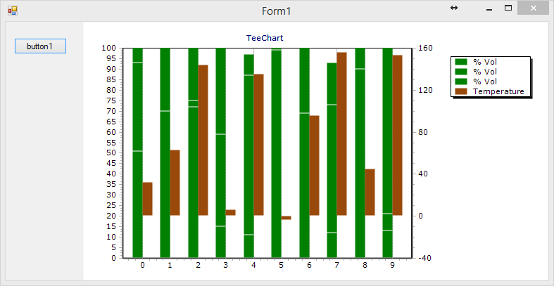

Post by Christopher » Mon Jun 09, 2014 9:09 am
tms4000 wrote:When I remove the SP1 SP2 and SP3 series and change the Mutibar property on the product seriers to MultiBars.Side, the Temperature series responds correctly to the origin property.
When I set Product.Multibar = Multibar.Stacked, the temperature series acts like 0 is the origin.
Just to confirm exactly what the issue is. I think I can reproduce the problem using this code:

which gives me this chart:
is this the issue you're referring to? If so I'll add it to http://bugs.teechart.net/ if you haven't done so already.
Post by tms4000 » Mon Jun 09, 2014 1:17 pm
Yes, that's the issue I'm seeing.
I have not posted it to your bug tracker. Could I be informed when this issue is addressed?
Post by Christopher » Tue Jun 10, 2014 8:28 am
tms4000 wrote:Yes, that's the issue I'm seeing.
The bug is has been posted here and has already been fixed; the fix will become publicly available in the next maintenance release, due out mid-summer.
