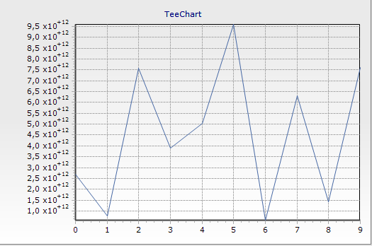

In the latest release, the following code:
Line series1 = new Line(tChart1.Chart);
Random rnd = new Random();
for (int i = 0; i < 10; i++)
series1.Add(i, rnd.NextDouble() * 10000000000000);
tChart1.Axes.Left.Labels.Exponent = true;
tChart1.Axes.Left.Labels.ValueFormat = "#.0 \"x10\" E+0";
gives this:
