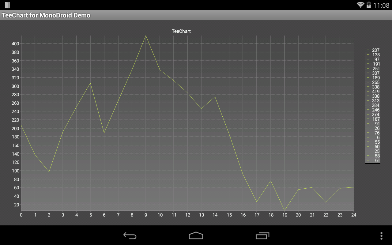

mainChart.Axes.Left.Grid.Style = Steema.TeeChart.Drawing.DashStyle.Dash;
any suggestion?

Hi Thinkpower,
It works fine for me here with an up to date Nexus 7 (2012) device, as you can see in the screenshot below. Are you using latest TeeChart for Xamarin.Android version available at the client area (build 4.13.12.13)? Could you please provide some more information about the environment in which you develop the application: android version, device features, etc.?
