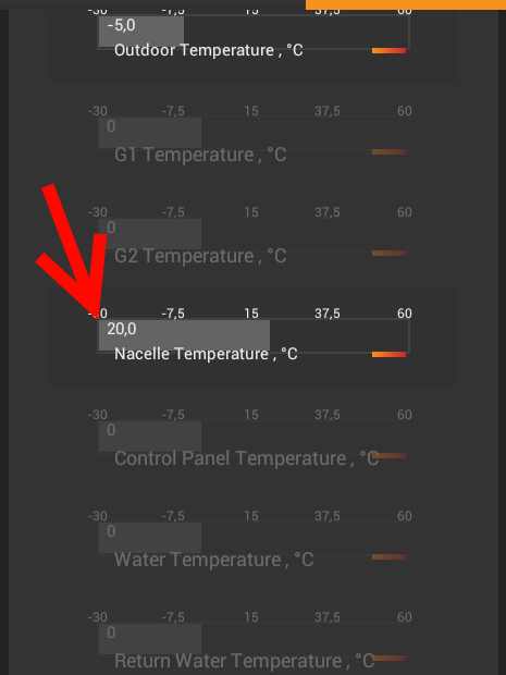

Hi! I'm using Xamarin.Android teechart.
I want to place numeric representation of value in LinearGauge in center of bar (like on screenshot)
I draw that value in AfterDraw event.
But when i calculate size from the top left corner of chart - and adjust it to specific device - on another device it is in wrong place (i use proper px to dp transformation). I need calculate text position from border top left corner (not whole chart corner)
1) how to get border top left corner coordinates (red arrow on screenshot)? i can't find appropriate properties.
2) how to change border color?
Thanks in advance

1. You can do this:
  public class MyLinearGauge : LinearGauge
    public MyLinearGauge(Chart chart) : base(chart) { }
    public Rectangle AxisRectangle
      get
        int height, width, x, y;
        if (Horizontal)
          height = Ticks.VertSize;
          width = Utils.Round(INewRectangle.Width * 0.8);
          x = (INewRectangle.X + (INewRectangle.Width / 2)) - (width / 2);
          y = INewRectangle.Y + ((INewRectangle.Height - height) / 2);
          height = Utils.Round(INewRectangle.Height * 0.8);
          width = Ticks.VertSize;
        return new Rectangle(x, y, width, height);

Re: LinearGage numeric value
Post by Thomas » Tue Jan 21, 2014 1:14 pm
Thanks. 1-st part works perfect.
Frame color deosn't work. When i make FrameVisible, disable Middle and outer bands It draws one more rectangle outside small thin frame. Seems like frame on first screenshot - is not related to LinearLayout.Frame property.

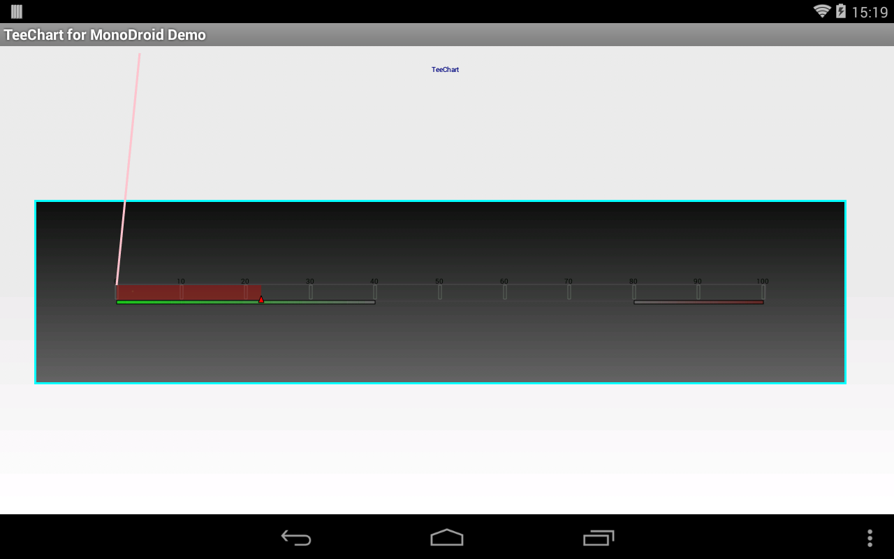

I have another problem. When i draw line from Point
topleft = gauge.AxisRectangle.Location;
from your first response everything is OK on all devices. The line draws from corner.
But when I try to draw text with
g.TextOut (topleft.X, topleft.Y, "1234");
text is drawed on different positions on Y axis on different devices. g.TextOut works with the same coordinate system? How to draw text in center of bar?
Post by Narcís » Wed Jan 22, 2014 10:26 am
Hi Thomas,
Thomas wrote:g.TextOut works with the same coordinate system?
Yes.
Thomas wrote:How to draw text in center of bar?
Continuing with the MyLinearGauge example, you can do this:
      Point topleft = gauge.AxisRectangle.Location;
      g.Pen.Width = 3;
      g.Pen.Color = Color.Pink;
      g.Line(topleft, new Point(200, 10));
      Point center = new Point(topleft.X + gauge.AxisRectangle.Width / 2, topleft.Y + gauge.AxisRectangle.Height / 2);
      g.Font.Color = Color.Red;
      g.TextOut(center.X, center.Y, "My custom text");

Post by Thomas » Fri Feb 14, 2014 12:31 pm
Still cannot change border color (see my 1st post in this topic).
Frame property is other frame, not the frame near hand (see attachment to first post).
Post by Narcís » Fri Feb 14, 2014 4:19 pm
Hi Thomas,
Apologies for the misunderstanding. That frame is the axis, hence you can change its pen properties like this:
      gauge.Axis.AxisPen.Color = Color.Red;
      gauge.Axis.AxisPen.Width = 5;
Is that what you were looking for?
