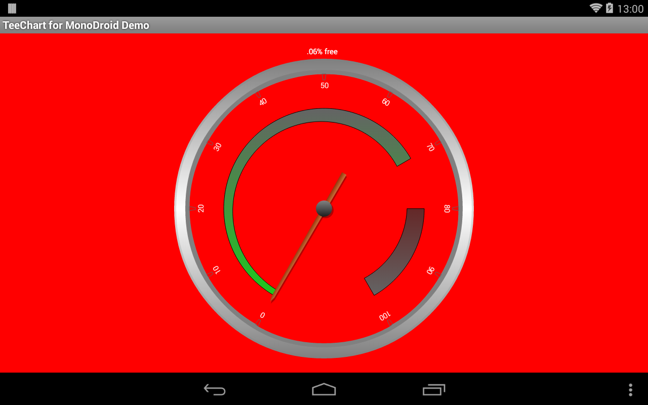

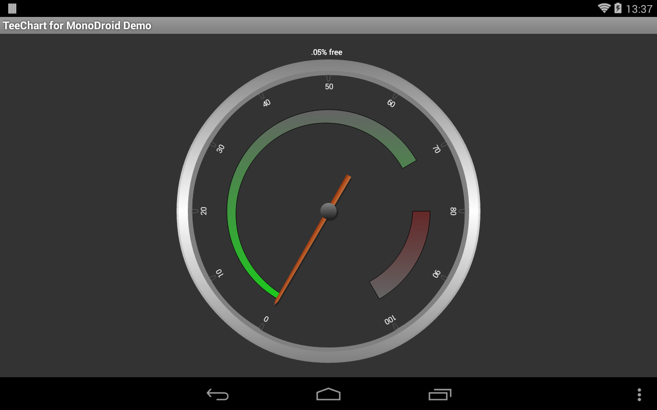

Which produced this chart:

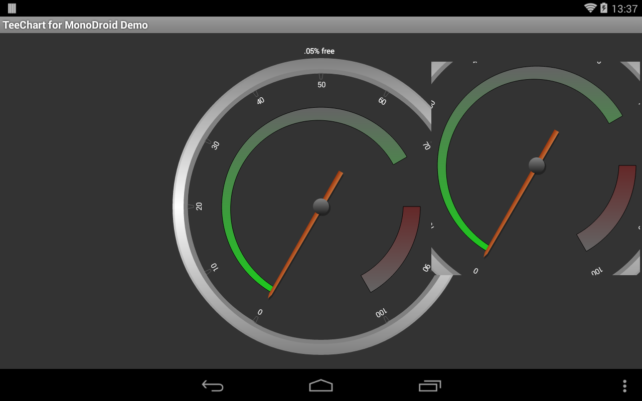

I copied a section of the CircularGauge over the panel to compare colors:
Honestly, using latest TeeChart for Xamarin.Android build (v4.13.12.13) from December 2013, I can not see any difference between circularGauge1.FaceBrush.Color and tChart1.Panel.Color. This can also be seen in red, for example:
Can you see any color differences? Can you reproduce the problem with the code I posted? If not, can you please modify my code snippet so that we can reproduce the problem here? Finally, which TeeChart for Xamarin.Android build are you using?

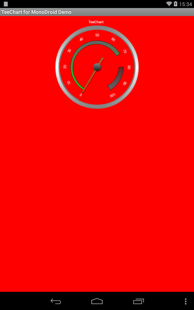

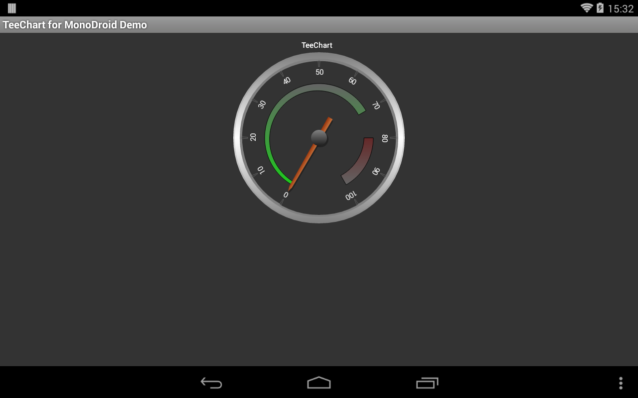

It produces those screenshots:
Does this code work fine at your end? Can you please modify it so that we can reproduce the problem here?
