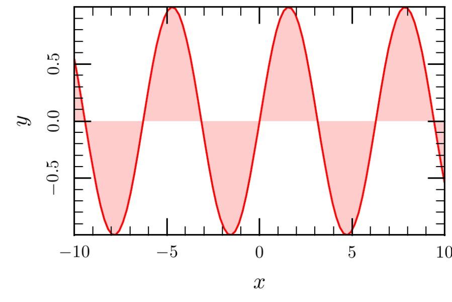

I have a question about filling a line series with color. I would like to fill a line series in one direction with color.
An example would be I have a line series "Test" with about 10 points, I take the avg of the 10 points and draw another line using the avg value. Now i want all the values lying above the avg to be colored on the series Test.
I tried to do this using the series band tool, the first series is the actual series called Test and the second series will the line drawn using the avg value. The issue here is there is no way I can specify on fill those values which are great than the avg. This fills values both greater than and lesser than mean.
To be brief, I would like to color the peaks and leave the troughs uncolored. Is there a way to do this ?

I attached a example, as image. In this image both the high and lows are filled with color. Assuming the line passing through the middle is avg. Can I just fill in the peaks (highs) ?
This is example from the web. Here both Peaks and troughs are filled. I Just want peaks filled.

This does not work as I want to fill in the curve, not change the line color of the curve.
I did a similar example here. This is a Delphi example. In .NET you can do something like the code below using CrossPoints function and HighLow series.

Thanks for the suggestion. However I have another issue, does this work if the curve is along the y axis ? I tried the highlow and it only seems to work for a curve along the x-axis.
The code does not seem to work if the value axis is the x-axis ? Can you please let me know ?
