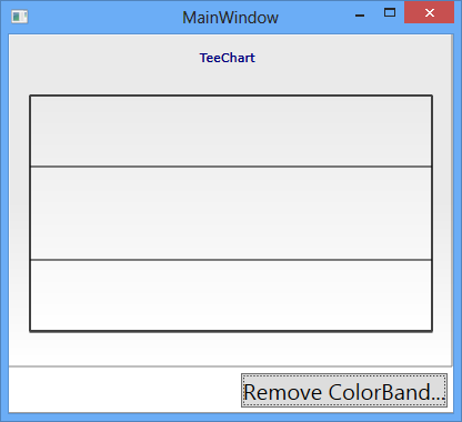

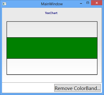

If I add ColorBand to TChart, then remove it, some dirt stays on the screen.
With ColorBand
After ColorBand removing

Hello neurosoft,
I can reproduce your problem. I have added it in bug list report with number [TW16016733]. We will try to fix it to upcoming versions of TeeChartFor.Net. On the other hand, at the moment, you can use next workaround to solve your problem:

Could you confirm us if previous code works in your end?
