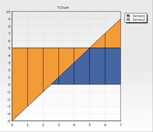

I have 2 area charts that are stacked and 1 of these charts has both positive and negative numbers and the other chart only has positive numbers. In this case some strange behaviour occurs (see image).
The code that I use is the following:
Steema.TeeChart.Styles.Area area = new Steema.TeeChart.Styles.Area(tChart1.Chart);
Steema.TeeChart.Styles.Area area2 = new Steema.TeeChart.Styles.Area(tChart1.Chart);
area.MultiArea = Steema.TeeChart.Styles.MultiAreas.Stacked;
area2.MultiArea = Steema.TeeChart.Styles.MultiAreas.Stacked;
for (int i = -5; i < 10; i+=2)
    area.Add(i);
for (int i = 10; i > -5; i-=2)
    area2.Add(i);
Is it possible to avoid this kind of behaviour and make sure that for instance there are no white spaces between the orange chart and the blue one (between x values 2 and 3)?

Hello OMP,
I could reproduce the problem here and added it to the bug list (TF02016717) to be fixed for future releases. I have also checked the VCL version doesn't reproduce this problem:
Is this the way you'd expect the chart to be rendered?
