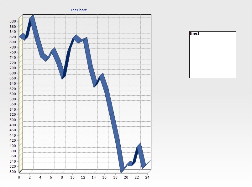

Using next code to make a custom legend:
I can export correctly the Chart and custom legend. See images GIF, JPEG, results:
Could you please, tell us which version of TeeChartFor.net are you using? If you use last version, could you please send us a simple code where we can reproduce your problem here?
private MyLegend myLegend;
this.Controls.Add(tChart1);
myLegend = new MyLegend(tChart1.Chart);
tChart1.AfterDraw+=new PaintChartEventHandler(tChart1_AfterDraw);
tChart1.Series.Add(typeof(Line));
tChart1[0].FillSampleValues();
tChart1.Panel.MarginRight = 40;
button1.Click += button1_Click;
void button1_Click(object sender, EventArgs e)
tChart1.Export.Image.JPEG.Save(@"C:\CustomLegend.jpg");
tChart1.Export.Image.GIF.Save(@"C:\CustomLegend.gif");
tChart1.Export.Image.PNG.Save(@"C:\CustomLegend.png");
tChart1.Export.Image.Bitmap.Save(@"C:\CustomLegend.bmp");
void tChart1_AfterDraw(object sender, Graphics3D g)
myLegend.Draw(g, Utils.FromLTRB(tChart1.Width - 200, 100, tChart1.Width - 50, 250));

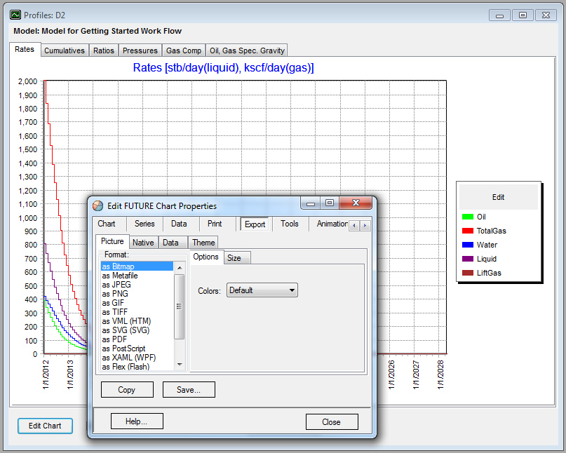

Hi Sandra,
How could we make this approach work with the Export tab of Steema.TeeChart.Editor?
We expose your editor to our users allowing them to customize charts, especially for reporting purposes. It seems to me, that any of your customers that extend TeeChart with custom annotations or legends would want the underlying TChart.Export.Image.xxx.Save(...) methods to exhibit WYSIWYG behavior by implementing the BitMap technique you suggest.
Would you agree that this is a valid feature request? Anything we implement would not extend the Steema.TeeChart.Editor, so unless you implement this within TeeChart, the Export feature of the Editor will not behave as users would expect.
Jay

Hello JCincotta,
First, you must know that if you add any tools as annotation, legend tool using editor, TeeChart has mechanisms that allow you export without problems the extra elements (annotation, extralenged) you add in the Chart, using our editor. You can achieve export in same way your custom components, always, if these inherit from TeeChart components (Series,Tools, etc).
Second, weeing your code, I have realized you use a external control that doesn't inherit by TeeChart components, moreover, when open the editor this control doesn't appear in any list of components (tools,series) and isn't possible add it in the chart, using chart editor. For this reason, I understand you use your own controls that don't inherit of TeeChart components and you want TeeChart export all extra controls automatically, although these don't inherit by TeeChart. We consider your request and I have added it as a feature request with number [TF02016679] to be consider its inclusion in future versions of TeeChartFor.Net.
