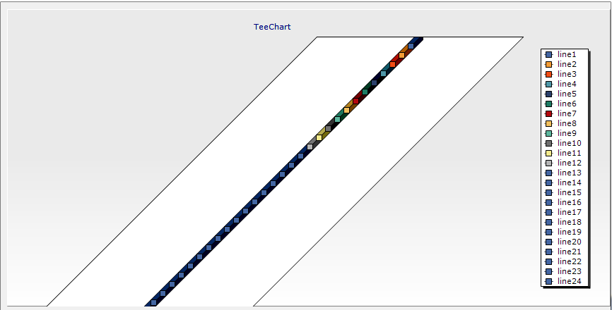

Dear,
When I add more then 25 lines in my chart which all have only 1 point, my 3D chart looks strange.
This my code:
chartToTest.Aspect.View3D = true;
            for (int i = 0; i < 30; i++)
               Steema.TeeChart.Styles.Line line = new Steema.TeeChart.Styles.Line(chartToTest.Chart);
               line.Pointer.Visible = true;
               line.Add(0, "");
Kind regards
3D chart.PNG (17.77 KiB) Viewed 12954 times

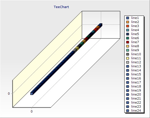

Using your code with latest maintenance release of TeeChartFor.Net ( Build 4.1.2013.05281):
    //  tChart1.Dock = DockStyle.Fill;
        Steema.TeeChart.Styles.Line line = new Steema.TeeChart.Styles.Line(tChart1.Chart);
        line.Add(0, "");
I have gotten next results where your problem doesn't appear.
Could you please tell us which version of TeeChartFor.Net are you using?

When I was making the test project, I have noticed that it depends on the size of the window and the number of lines that are used.
In the test project I couldn't reproduce it with 30 lines, but when 50 lines are used, the issue is still there.
I will send the test project to support.

I've attached the project here now. My apologies for the misunderstanding.
TeeChartTest.zip
(112.47 KiB) Downloaded 805 times
