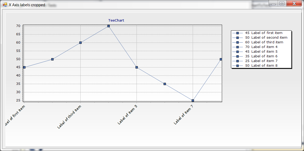

Dear,
If we have long text labels on the X Axis, the first label gets cropped when we rotate them. see screenshot attached.
What can I do to make sure that the label does not get chopped off.
thanks,
Marijke Van Bergen
OM Partners.

Post by Sandra » Fri Jun 21, 2013 11:15 am
Hello Marijke Van Bergen,
I recommend try to increase the space of MarginLeft adjusting it to your convenience. For example, you can do something as next:
      tChart1.Panel.MarginLeft = 10;

Post by OMP » Mon Jun 24, 2013 7:01 am
The problem with this solution is that our data on the chart (including the labels) in very dynamic. We never know the length of the labels, so setting a hard coded margin is not the best solution. We are looking for a solution that takes into account the length of the labels.
Kind regards,
Marijke

Post by Sandra » Tue Jun 25, 2013 10:17 am
Hello OMP,
You can use MaxLabelsWidth to calculate the width of your labels:
 private void CalcMargins()
      tChart1.Draw();
      tChart1.Panel.MarginUnits = Steema.TeeChart.PanelMarginUnits.Pixels;
      tChart1.Panel.MarginLeft = tChart1.Panel.MarginLeft+tChart1.Axes.Bottom.MaxLabelsWidth();
My recommendation is you use a similar code as previous to fix your problem.
