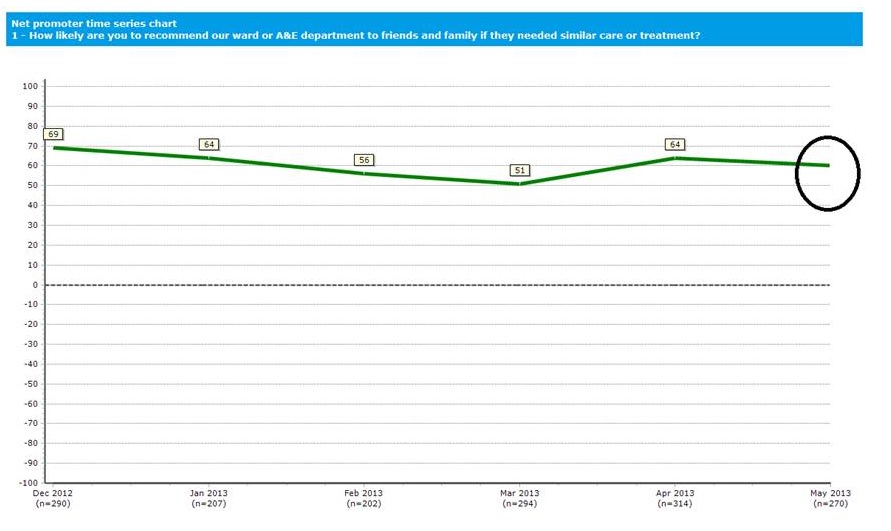

What would cause the last number on the line graph mark to not show, as per the sample? It does this regardless to number of months of data

Hello mikethelad,
I suggest you modify your Maximum and Minimum offset. You can do something as next:
            tChart1.Axes.Bottom.MaximumOffset = 1;
            tChart1.Axes.Bottom.MinimumOffset = 1;
Could you tell us if previous lines help you to solve the problem?

Post by mikethelad » Thu Jun 13, 2013 2:27 pm
Thanks, this has resolved it
